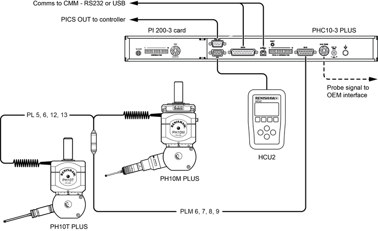

System interconnection diagrams
PH10 PLUS system with standard two wired touch-trigger probes

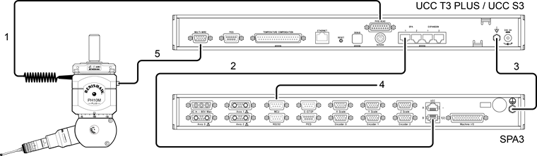

PH10 PLUS system with standard two-wire touch-trigger probes and HCU2
PH10 PLUS system with standard two wire touch-trigger probe and autochange
PH10 PLUS system with standard two-wire touch-trigger probes autochange and HCU2
Key
Description
1
Communication connection to CMM controller RS232 or USB
3
Communication to CMM controller
4
Communication to autochange rack
5
PICS output to CMM
6
Probe output to CMM controller

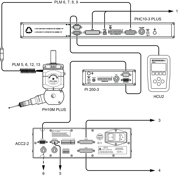

PH10 PLUS system with standard two wire touch-trigger probe, PI 200-3 and autochange
PH10 PLUS system with standard two-wire touch-trigger probes PI 200-3 autochange and HCU2
Key
Description
1
Communication connection to CMM controller - RS232 or USB
3
4
5
PICS output to CMM controller
6
Raw probe output to CMM contoller
