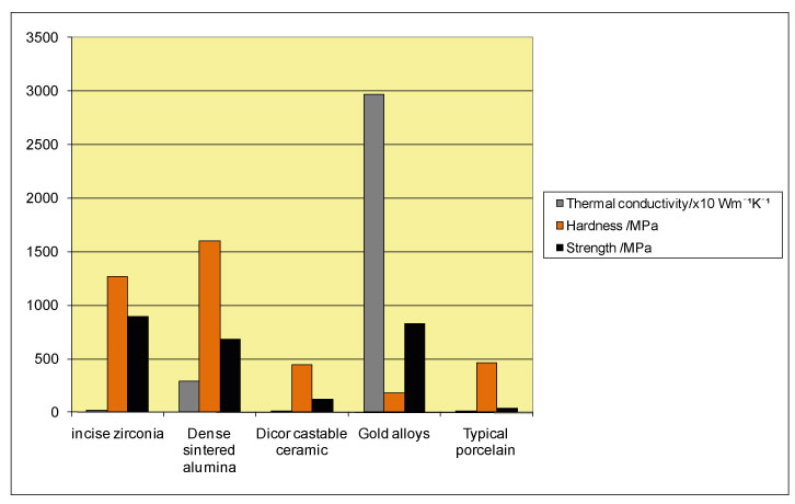

Optimal dental materialsThe incise software can support both ceramic and metal frameworks, minimising messy manual processes and giving you a ‘one stop shop' for all your restorative dentistry needs: Zirconia
incise uses yttria-stabilised tetragonal zirconia (Y-TZP), certified to ISO 13356:1997. Much stronger and tougher than alumina, it is suitable for long-span bridges as well as crowns and is guaranteed for 10 years. Zirconia is also the best dental material for thermal insulation, enhancing patient comfort. incise zirconia provides an optimal combination of strength and low thermal conductivity, whilst also being less hard and therefore more workable than alumina:
