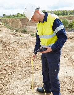

Cabled Boretrak deployment on face
The complete Cabled Boretrak system fits neatly in a rugged 'Peli' case.
In the field, all that is required is the probe, with cable attached, and a toughened CDU to record data - that's a total weight of just 5 kg.
Cabled Boretrak deployment first involves lowering the unit to the bottom of the hole via the integral cable, which is toughened for durability.
Users can retrieve the unit at 2 m intervals. At each interval a single button press on the CDU is required. The dual-axis tilt sensor and digital compass calculate borehole deviation at each interval.
Data is saved in the CDU and downloaded in the office via serial cable.
Cabled Boretrak is supplied with a weighted extension piece, which customers fill with lead shot or sand, to ballast the system in deep or flooded holes.
