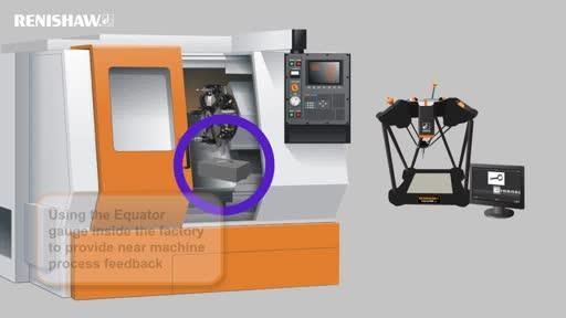

Equator is a radical new alternative to traditional dedicated gauging, filling a gap in the market never before addressed. It is more than just a new gauging system, it marks the launch of Renishaw’s first gauging product line.
Equator's innovative and highly repeatable gauging technology is based on the traditional comparison of production parts to a reference master part. Re-mastering is as swift as measuring a production part and immediately compensates for any change in the thermal conditions of a shop-floor environment. Equator can be used in factories with wide temperature variation – simply re-master and the system is ‘re-zeroed', ready for repeatable comparison to the master.

‘Master' part comparison
A known good part, or 'master' part, is scanned to generate a master data set. The same scanning routine is applied to each of your production parts. Each production data set is compared to the master data set to determine whether the associated part is within user defined tolerances.
