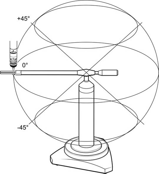

The Renishaw MCG is a straightforward test that allows users to check the volumetric accuracy of a CMM, whatever its size.
Based on a simple alternative to the widely used 'Ball-bar principle' - typically used to check the accuracy of machine tools - the Renishaw MCG provides fast, automatic machine evaluation in accordance with ISO 10360-2, the international standard for the acceptance and re-verification of co-ordinate measuring machines.
Volumetric Performance
A counter-balanced arm of known length is located at one end on a stationary, freestanding pivot positioned on the CMM table. The pivot allows the arm to rotate very accurately through 360° horizontally and +/-45° vertically. Each MCG comes with 6 arms, from 101 mm to 685 mm in length, and pillars from 72 mm to 235 mm in height.
The other end of the arm comprises two parallel guide rods with sufficient clearance between them to allow the CMM probe to move towards the pivot position, taking a radius measurement as the probe stylus ball contacts a ball attached to the end of the arm. As the arm is a known length, any discrepancy between this length and the measured CMM value can be calculated.
A standard test provides for 8 measurements at each of 0°, 45°and -45° arm elevation, giving a total of 24 points. The process is repeated three times to allow for machine repeatability, producing 72 results in all.
As the volumetric measuring performance of the CMM is the maximum error between any two points in any plane, over any distance within the full measuring volume, the test can be performed at multiple locations around the machine table.

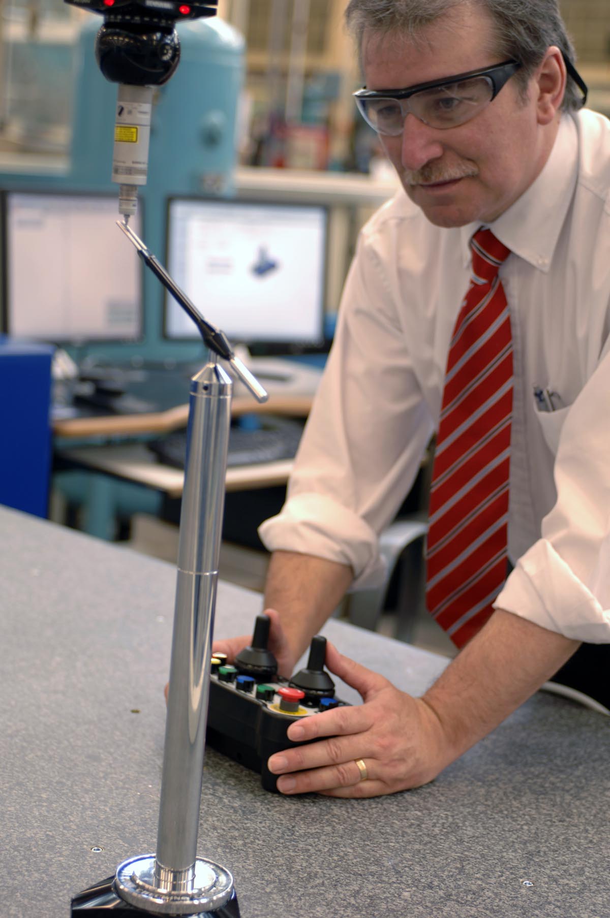

Mr Willis says "As part of the ISO 10360 standard which defines the process of CMM verification, we use the Renishaw Machine Checking Gauge to perform the interim verification requirements. Following each ISO 10360 calibration of the CMM the MCG is used to capture and record performance values, these results serve as the reference standard against which deterioration in the machine's performance can be determined.
The MCG is used monthly and the results are graphed to visualize the effects of any changes taking place. Additionally, in line with ISO 10360 requirements, a probing system verification routine is performed each week. The Machine Checking Gauge is also a major benefit if we have an unexpected collision on the machine; with the Renishaw MCG we can quickly understand any effect this has had on machine performance and confidently decide if we can continue to use the machine.
Users of the Renishaw MCG can download test programs and analysis software from the company's website.
"By graphing the results, we can watch the machine accuracy deviate at the end of each month," says Mr Willis. "If the machine deviates too much too soon, we stop using the CMM and call the calibration company to re-qualify the machine."
Users can also save and archive MCG data to the Renishaw server, allowing them to compare results over the lifespan of a machine.
