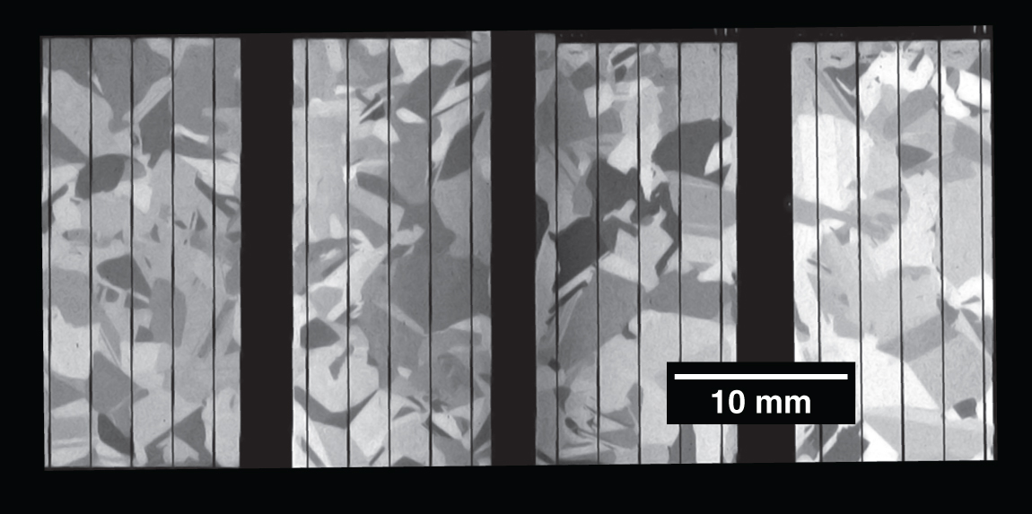

Polycrystalline silicon cells consist of a series of multiple domains with different crystal orientations. Where a larger number of small domains are present, the efficiency of these cells is reduced, due to the large number of boundaries between the domains. The Raman image above shows how StreamLine imaging can be used to identify the different domains: we then use this information to quantify the boundary distance. The ability to sample data over very large areas, seamlessly, in minutes, makes StreamLine imaging the ideal method for rapidly surveying these cell modules.
Where high spatial resolution images are required (for example, to determine inter-domain variations and the affect of domain boundaries on device stresses), StreamLine's high resolution imaging is the method of choice. This method enables users to acquire information-rich images on the sub‑micrometre scale. Renishaw also provides systems for on-line solar panel inspection for quality assurance applications during manufacture.
