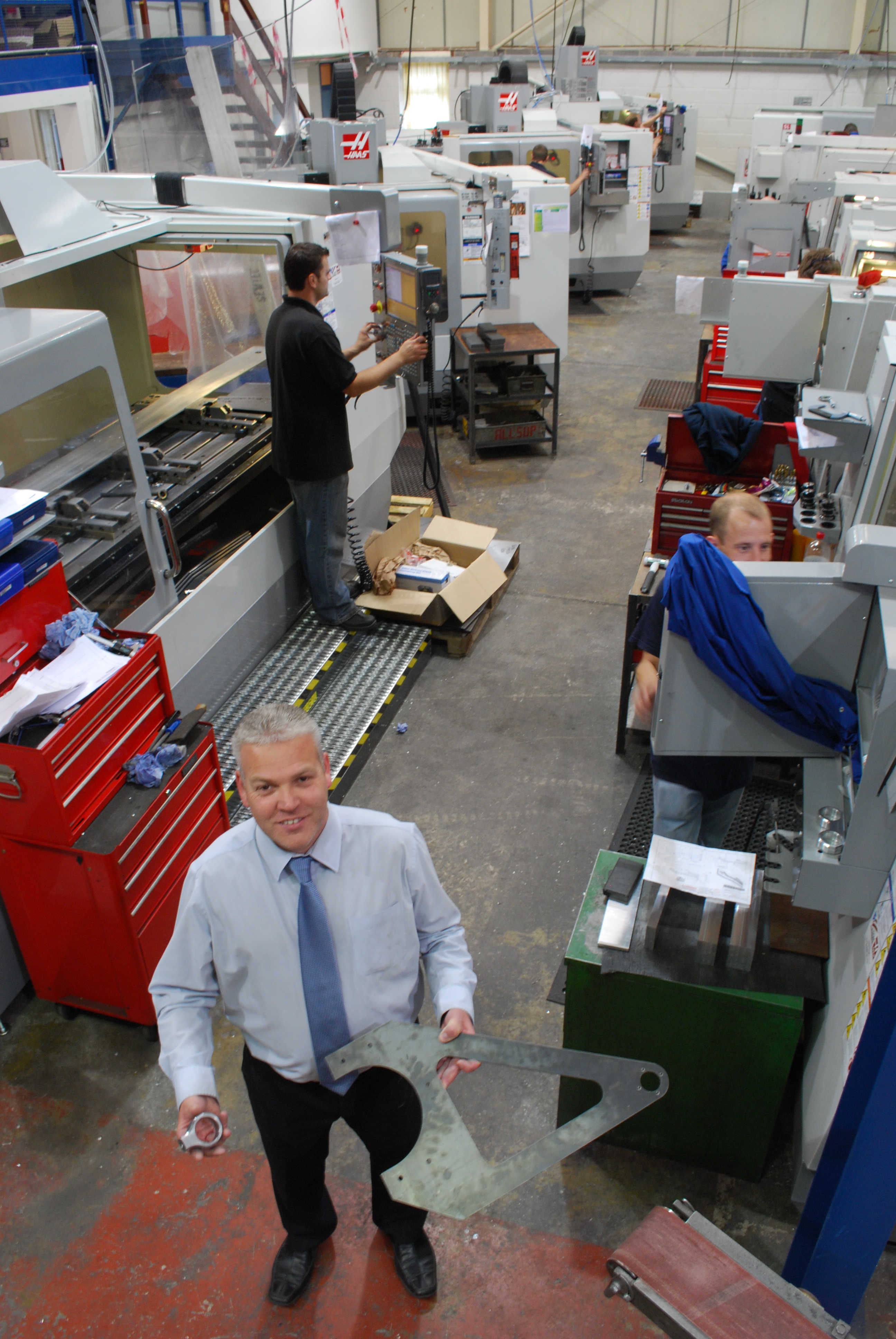

Jerry Elsy, Sewtec’s Production Manager, with components produced on the HAAS vertical machining centresSewtec Automation, a world leading supplier of production and packaging systems for the fast moving consumer goods sector, has dramatically increased machining output by adding 5 new HAAS machine tools with Renishaw touch probes, and a new system of shift work.

Sewtec machines are supplied globally to manufacturers of confectionery, biscuits, tea and other consumer goodsSewtec has decided to invest time in refining the set-up of its machines, with the intention of leaving them to run on their own as much as possible. With some important progress made towards this goal a skeleton night shift has been created, with 4 operators running between 8 and 10 machines, depending on the production needs.  The spindle probes and tool setting probes are an important factor in enabling this.
