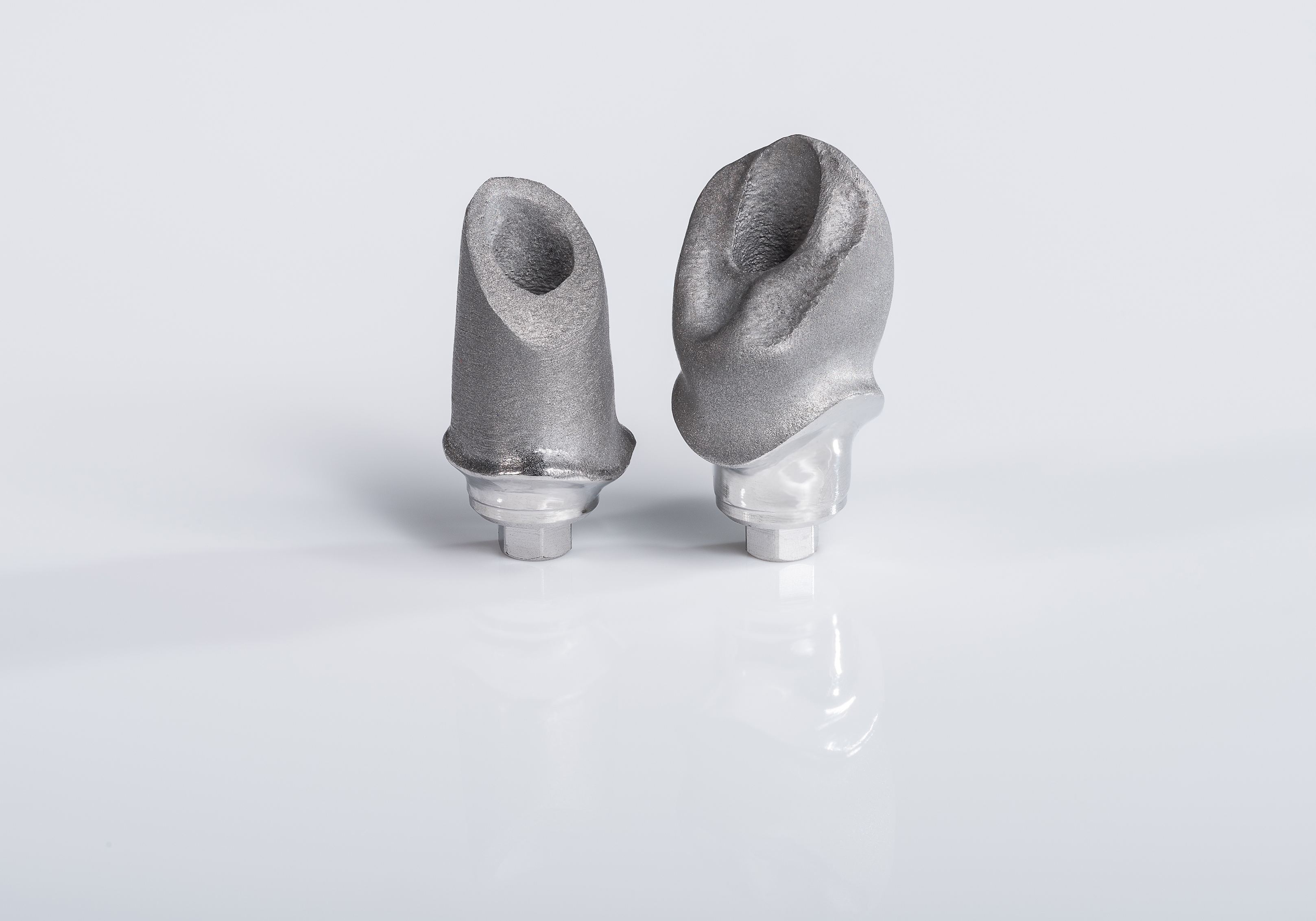

The new offer provides a technologically advanced custom abutment made by Renishaw's hybrid manufacturing, which is 3D printed to capture fine occlusal details, and then precision machined to achieve precisely fitting interface geometry for screw-retained implants.
Following an ISO 13485 approved quality management system, the abutments are made from CoCr that has been biocompatibility tested according to ISO 10993. This enables standard porcelains to be bonded to the surface without a separate coping/crown, providing a screw-retained crown which can later be temporarily removed for hygienic maintenance or work on adjacent teeth.
Using Renishaw Dental Studio (RDS) software, dental labs design their abutment in-lab and submit it digitally to Renishaw central manufacturing, making LaserAbutments highly accessible to dental laboratories.
LaserAbutments are supplied with a pre-polished emergence profile, helping to save laboratory time, and with a titanium screw for each abutment.
