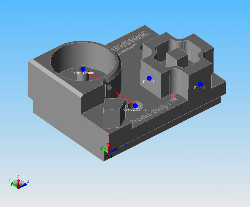

Constructed Line generation on solid model
Available autumn 2011, Productivity+™ is a unique software solution for the integration of measurement and process control functionality into CNC machining programs. Providing significant advantages over traditional methods, Productivity+ eliminates the requirement for the manual addition of probing cycles into G-code, instead using ‘point and click' feature selection from imported solid models within an interface immediately familiar to existing CAM users.
Already the most powerful tool available for using on-machine measurement to control manufacturing processes, Productivity+ version 1.90 builds further on existing functionality and flexibility, including more features for Constructed Statements, enhanced multi-axis capability, improved reporting capability, and more Custom Macro functionality.
The constructed statements functionality within Productivity+ which allows ‘virtual' features to be created from existing measurement data, is complemented by the addition of a new constructed line element. Together these constructed statements (point, circle, plane and line), are suited complex job set-up operations.

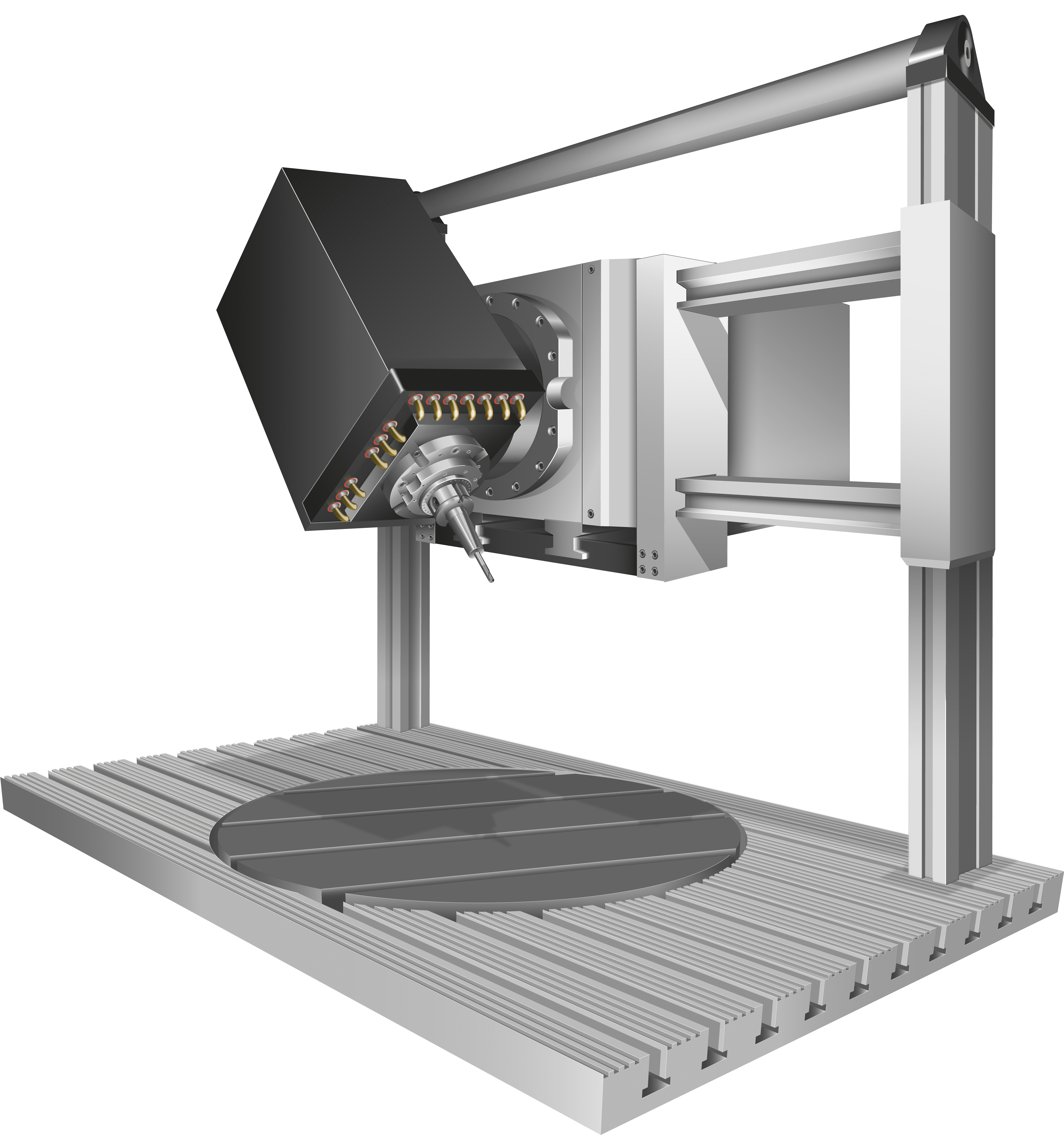

Head/table machine configurationMulti-axis capability and support for machine specific commands such as Fanuc G68.2 and Siemens CYCLE800 has been also extended in version 1.90, providing programming support for knuckle-jointed (nutating) table and 5-axis head/table machine configurations, as well as standard 3-axis machines and multi-axis machines with table/table configurations.
