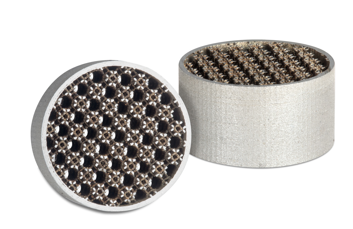

Laser melting systems
Laser melting cylindersVisitors to IMTS 2012 will be able to see Renishaw's new laser melting systems, which utilise a pioneering, additive manufacturing process capable of producing fully dense metal parts direct from 3D CAD, using a high-powered fibre laser. Parts are built from a range of fine metal powders that are fully melted in a tightly controlled atmosphere, in layer thicknesses ranging from 20 to 100 microns.

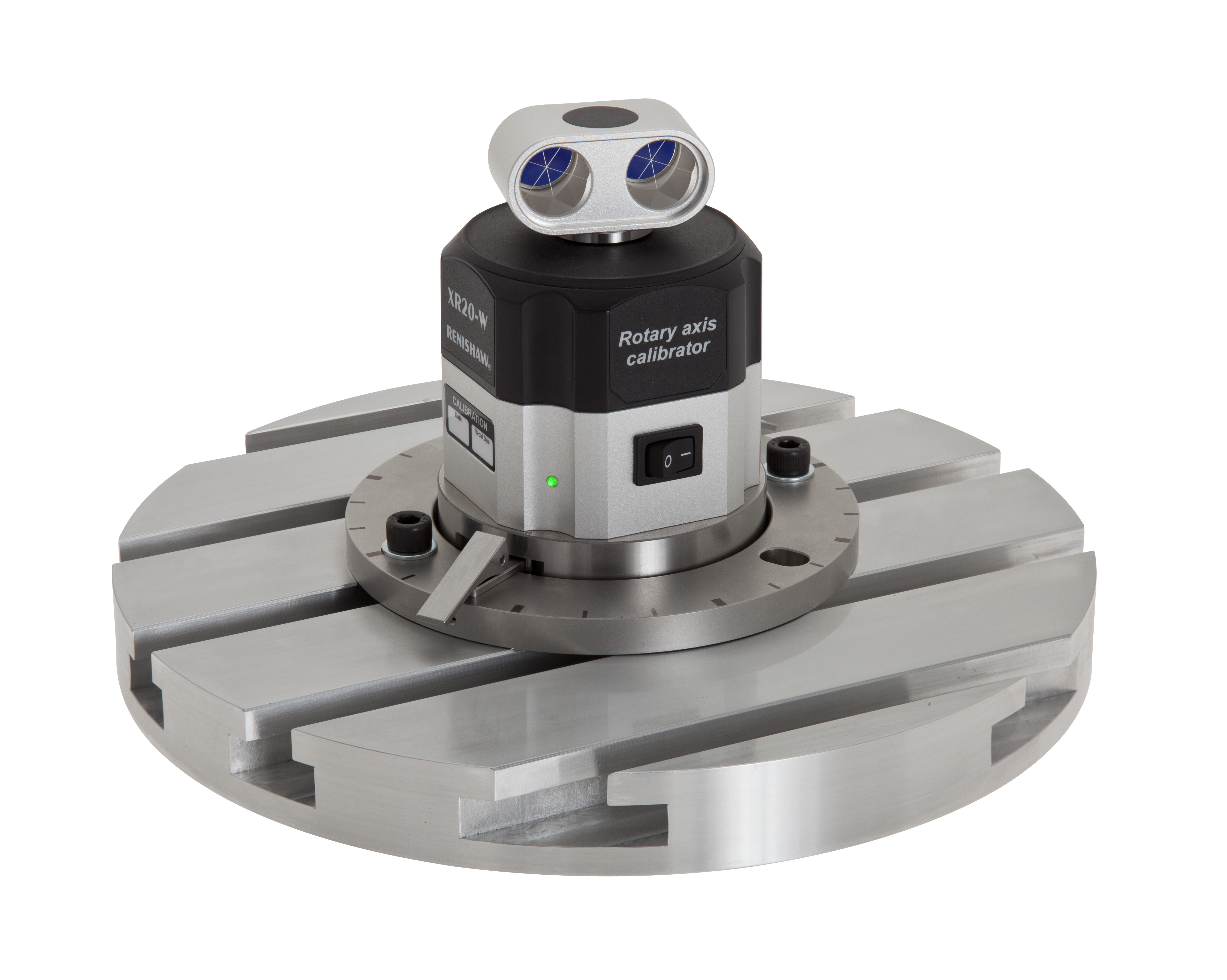

XR20-W rotary axis calibrator
XR20-W rotary axis calibratorAlso being shown at IMTS 2012 for the first time is Renishaw's new XR20-W rotary axis calibration system, which works with the market leading XL-80 laser interferometer system to allow the measurement of rotary axis positional accuracy to within 1 arc second. Totally wireless operation and modular mounting systems ensure suitability for a wide range of machines.
