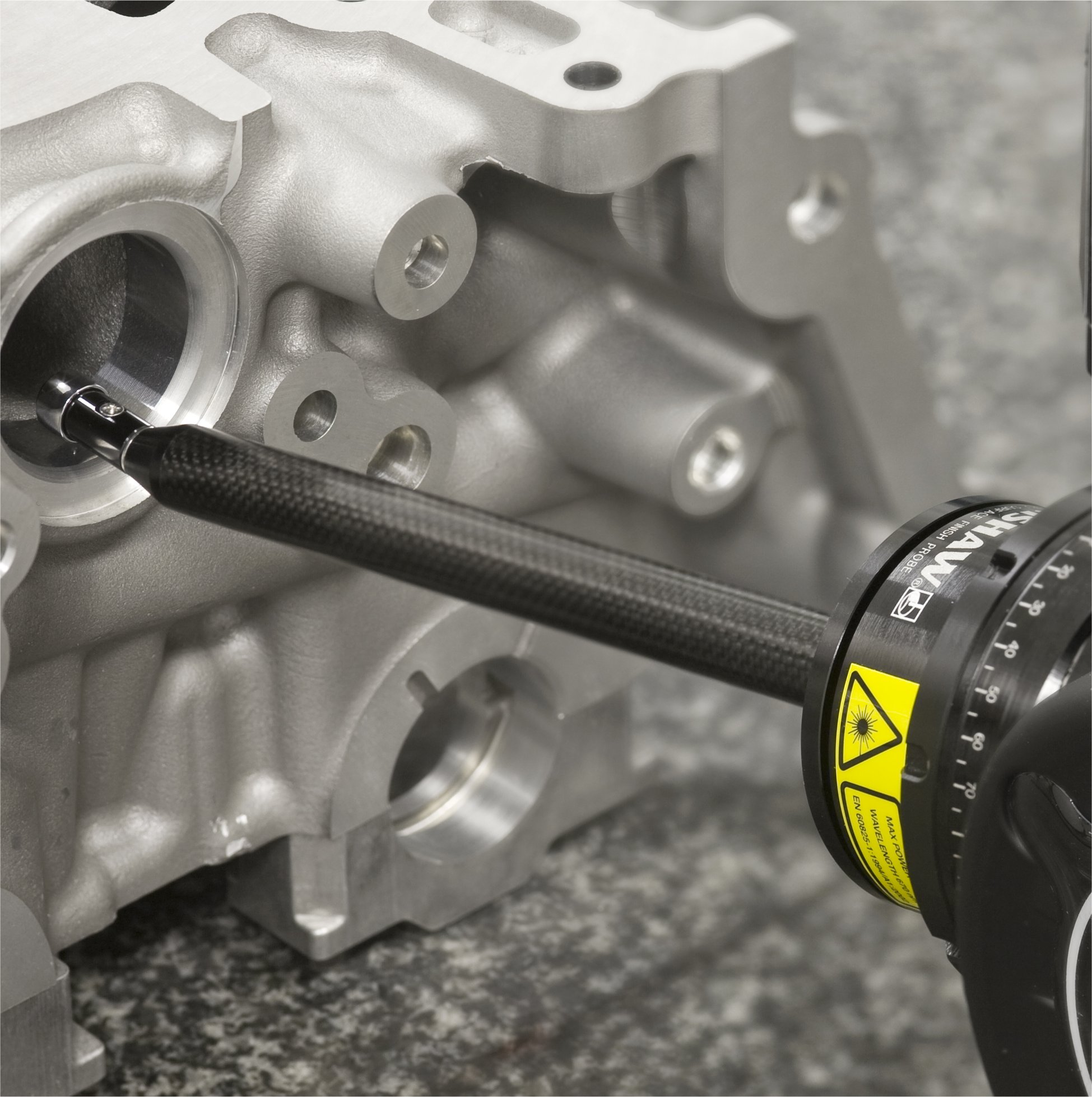

REVO surface finish probeAt IMTEX 2013 Renishaw will also demonstrate a new surface finish probe option for its revolutionary REVO five-axis measurement system. The new probe allows surface finish inspection to be fully integrated within CMM measurement routines. With a measurement capability of 6.3 to 0.05 Ra, the SFP1 surface finish probe provides a unique 'single platform' that will eliminate the need for hand-held sensors, or the necessity to move parts to costly dedicated surface finish measuring machines, reducing labour costs and inspection lead times. Using REVO, CMM users will now be able to automatically switch between part scanning and surface finish measurement, with analysis all contained in a single measurement report.
