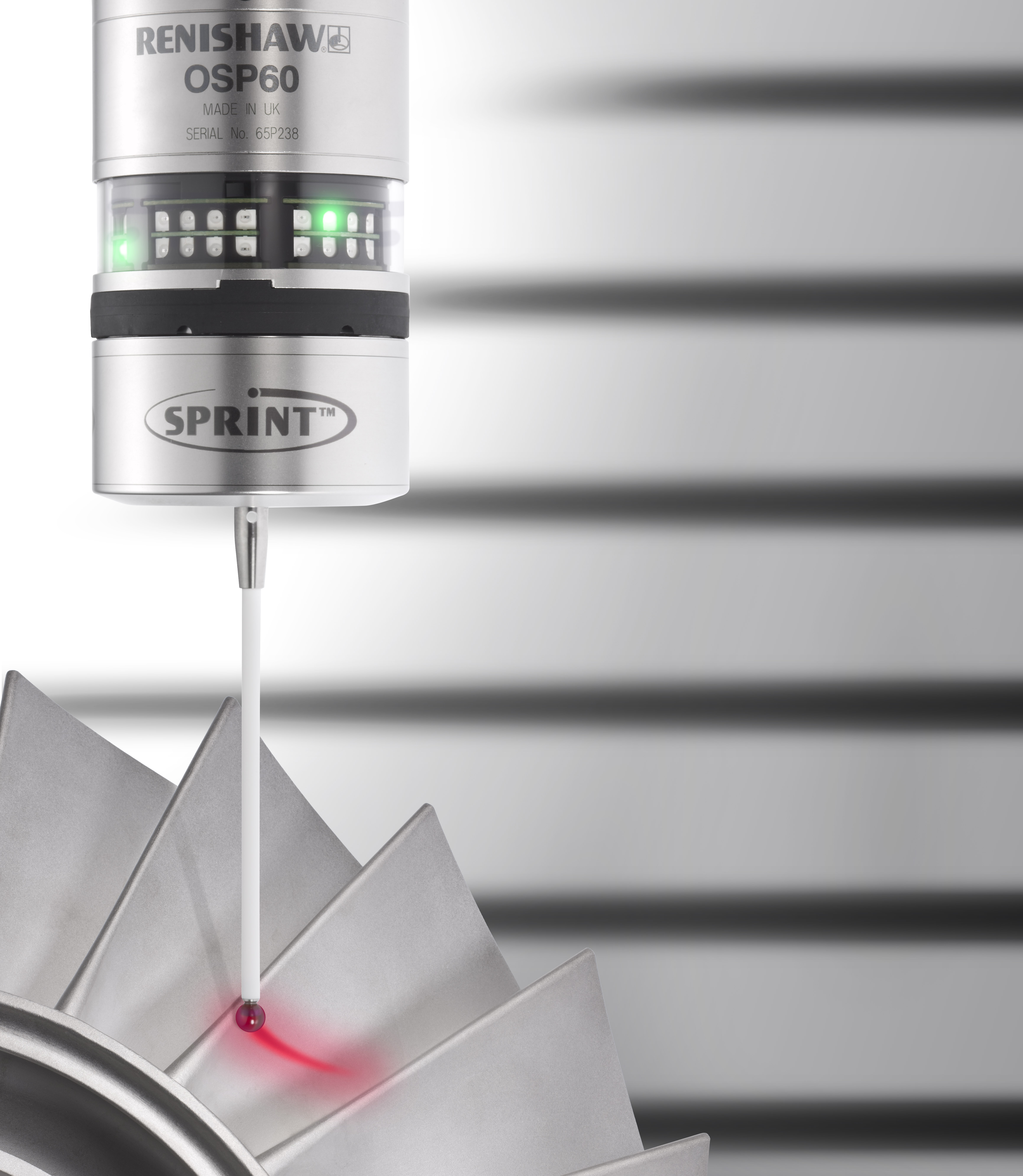

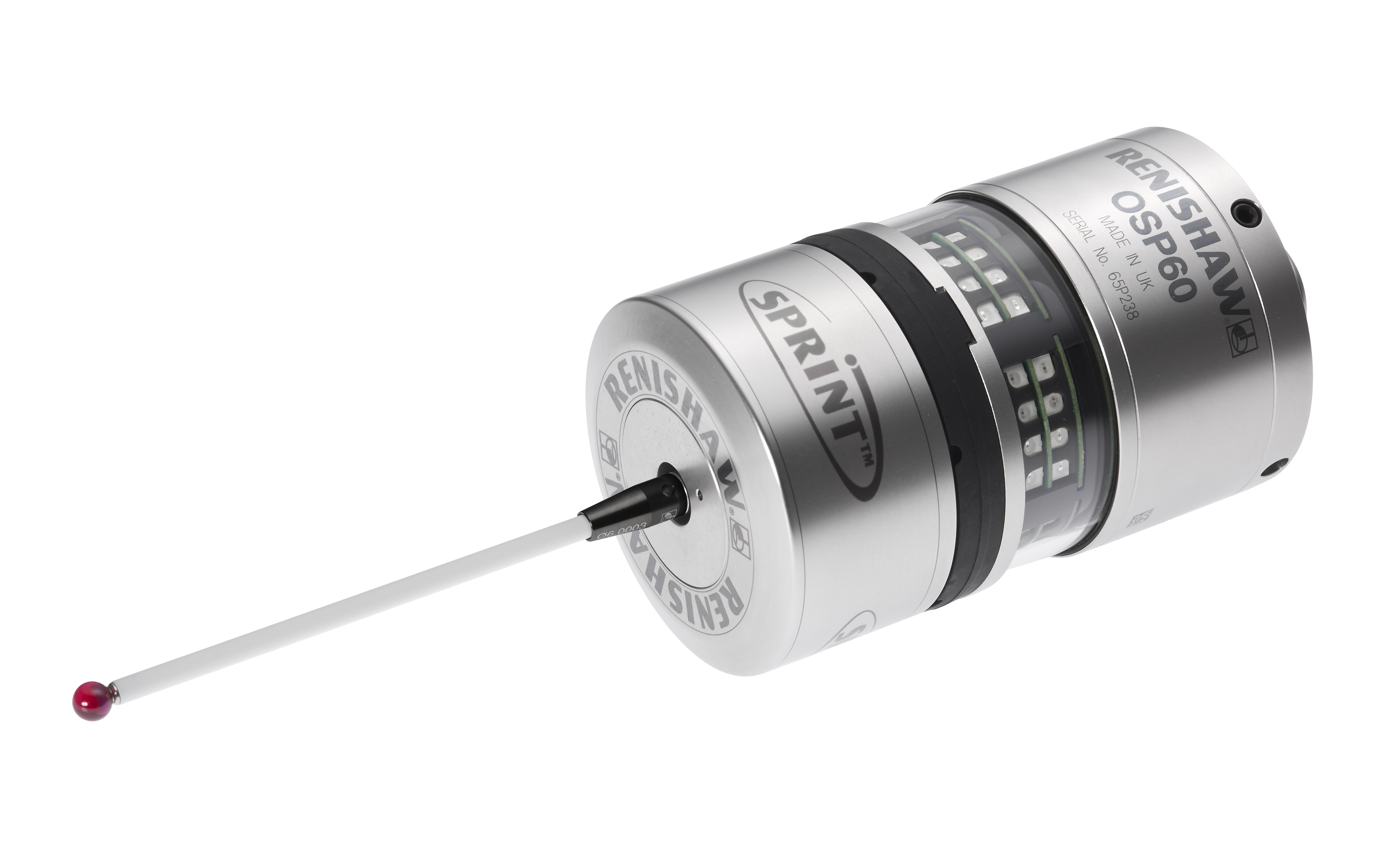

At the core of the SPRINT system is the revolutionary OSP60 scanning probe. The OSP60 probe has an analogue sensor with 0.1 μm resolution in three dimensions, providing exceptional accuracy and the greatest understanding of workpiece form. The analogue sensor technology in the probe provides a continuous deflection output that is combined with machine position to derive the true location of the part surface. Measuring 1000 true 3D data points per second, the system's superior analytical capabilities provide unparalleled opportunities for workpiece measurement, inspection, adaptive machining and on-machine process control, whilst optimising machine utilisation and cycle time. This new scanning technology opens up new process control methods not previously possible with other measurement methods.
