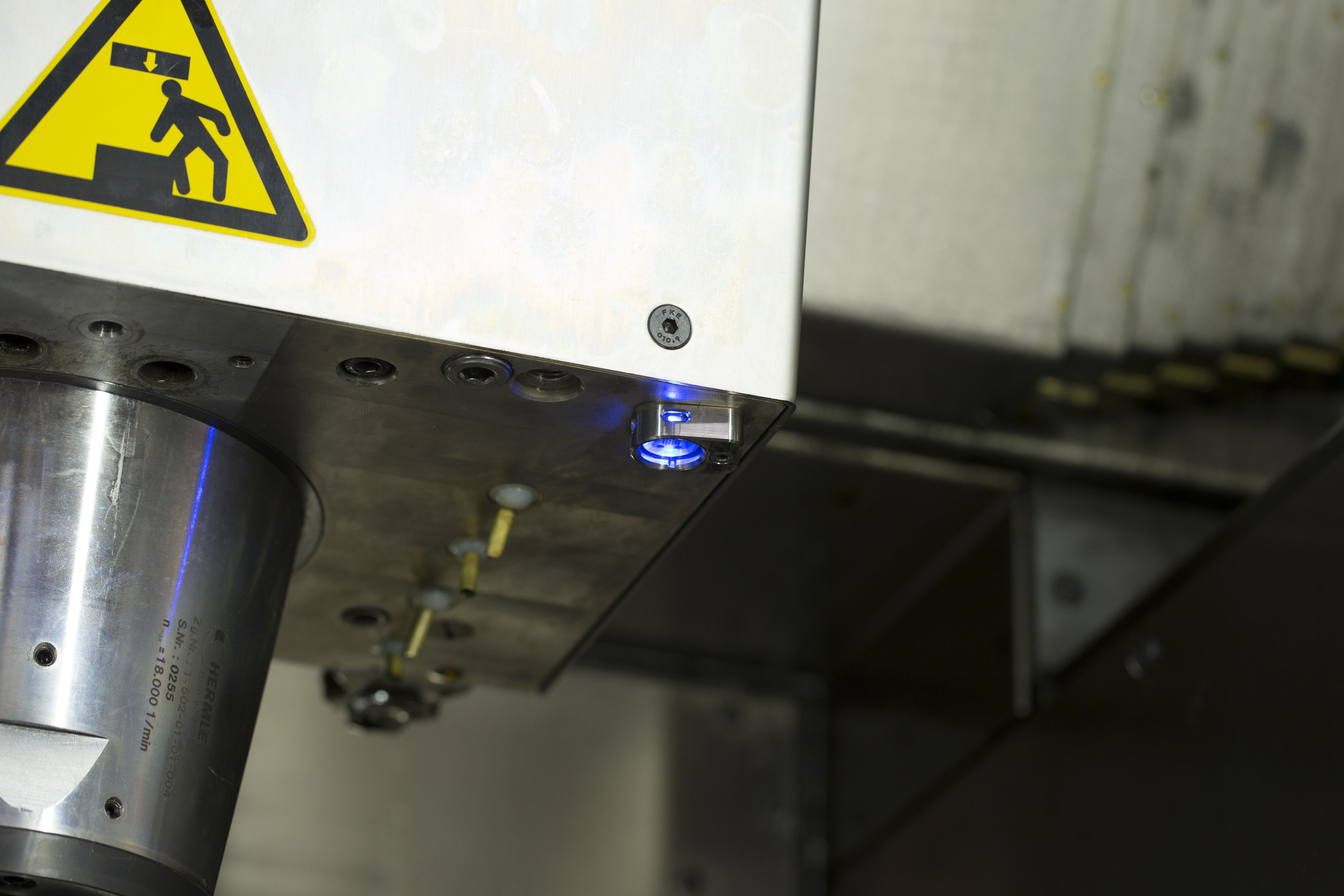

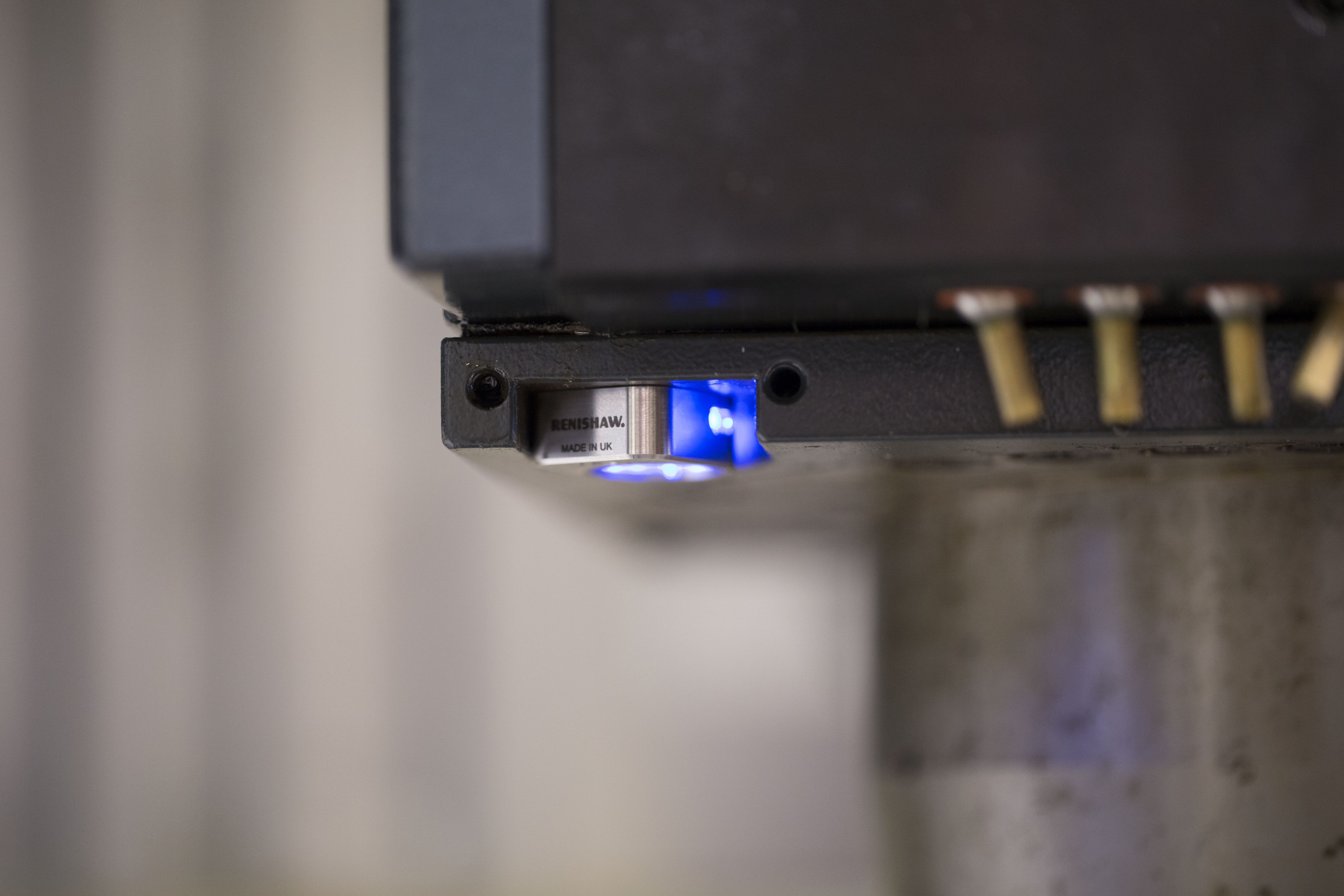

Expanding on the highly successful OSI/OMM-2 optical probe interface system, the introduction of the new spindle-mounted OMM-2C receiver provides a compact and convenient solution allowing installation of up to three Renishaw machine tool touch probes with optical signal transmission communicating via a single interface.
System design ensures robust operation whatever the operating environment. Utilisation of Renishaw's ‘modulated' optical transmission technology offers unparalleled resistance to light interference, whilst an optional, integrated air blast ensures the receiver window remains clean and debris-free for uninterrupted system communications.
During operation, side and front-facing LEDs provide users with a constant, clear and simple indication of system status, visible from all around the machine tool.
The new OMM-2C receiver retains the same connector and footprint as the current OMI-2C, providing an easy upgrade path for existing users wishing to take advantage of a multi-probe system.
