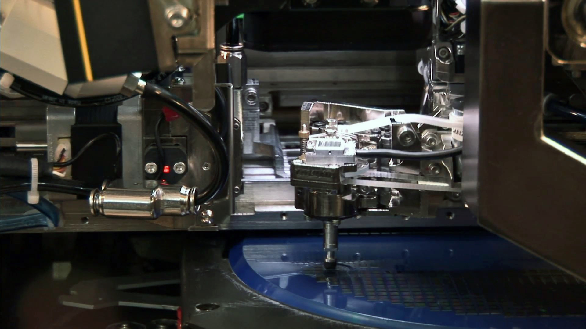

Renishaw's RESOLUTE absolute optical encoder is now compatible with the Yaskawa serial communications protocol in linear and rotary (angle) encoder formats. This allows RESOLUTE to be used with Yaskawa's drives and controllers such as the Sigma 7 range of servo-products. Yaskawa equipment is regularly used in electronics assembly, Flat Panel Display (FPD) manufacturing, factory automation and general motion control applications.
A priority for many motion control applications is to increase throughput, accuracy and machine performance. The choice of a dependable, accurate and low-latency encoder for position feedback is vital for servomotors. RESOLUTE true-absolute encoders allow both linear and rotary axes to be run harder and for longer – providing maximum up-time, throughput and yield. RESOLUTE's unique operating principle is analogous to a high speed digital camera, capturing images of the scale, and enables resolutions as low as 1 nm (30-bit on rotary scales) even at linear speeds of up to 100 m/s (36 000 rev/min on a rotary scale of diameter 52 mm). An advanced optical detection scheme produces intrinsically low Sub-Divisional Error (SDE) and low signal noise (jitter) - giving end users the benefit of exceptional dirt immunity, lower velocity ripple and rock-solid positional stability.
RESOLUTE encoders allow improved process performance, such as: higher numbers of components placed per hour (CPH) for surface mount technology (SMT), faster drilling operations for printed circuit board (PCB) drilling machines and reduced inspection times for other electronic assembly machinery. Furthermore, RESOLUTE is a true-absolute encoder which accurately reports the position of axes immediately upon switch-on. This eliminates the need for a datum homing cycle and provides instant commutation for linear motors, so machines can be restarted more quickly and in a secure, controlled manner. Absolute encoders are essential for certain types of robots, such as hexapods and wafer-handling robot arms, that risk damage to either themselves or their payload if forced to home after a power outage, for example.
