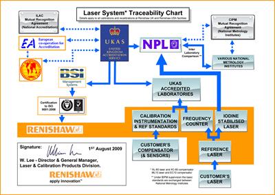

Laser system traceability chart - UK and USATraceability is characterised by six essential elements
  • An unbroken chain of comparison. An unbroken chain of comparisons originating at national or international standards of measurement and ending with the comparison of the local working reference standard and the unit under test.
  • Measurement uncertainty. The measurement uncertainty for each step in the traceability chain must be calculated according to defined methods and must be stated at each step of the chain so that an overall uncertainty for the whole chain can be calculated.
  • Documentation. Each step in the chain must be performed according to documented and generally acknowledged procedures and the results must be documented, i.e., in a calibration or test report.
  • Competence. The laboratories or bodies performing one or more steps in the chain must supply evidence of technical competence.
  • Reference to SI units. Where possible, the primary national, international or intrinsic standards must be primary standards for realisation of the SI units.
  • Recalibrations. Calibrations must be repeated at appropriate intervals in such a manner that traceability of the standard is preserved.
All instruments and artefacts used in the factory calibration of Renishaw XL-80 and ML10 laser systems and QC10 ballbars are fully traceable to UKAS accredited laboratories and thus to national standards. Traceability data (artefacts used and calibration details) is included on each calibration certificate and, in addition, traceability flow charts for Renishaw UK, USA and Germany can be downloaded from this page.
