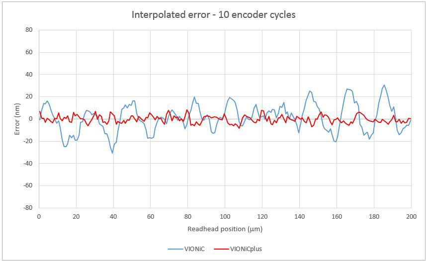

Sub-Divisional Error (SDE)
Ultra-low Sub-Divisional Error (SDE) of typically <±30 nm for VIONiC and <±10 nm for VIONiCplus linear readheads.
VIONiC SDE graph
