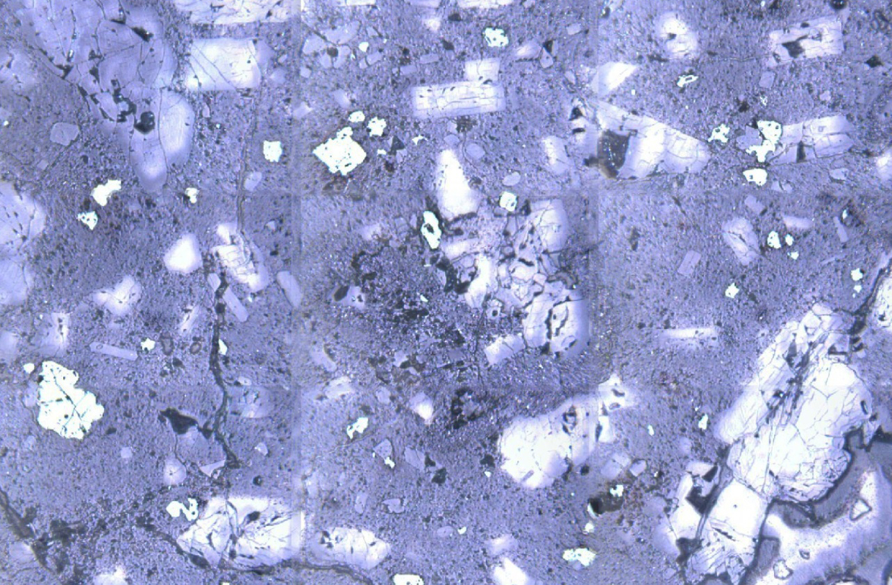

  • volcanic rock wl
    White light image of volcanic rock

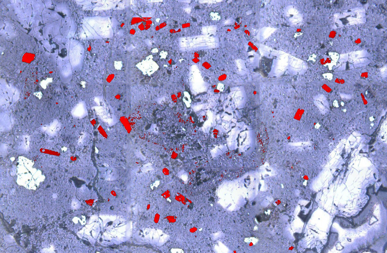

  • volcanic rock Raman
    Raman overlay image of volcanic rock

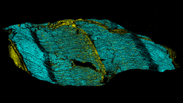

  • Tigers Eye rock Tigers Eye rock

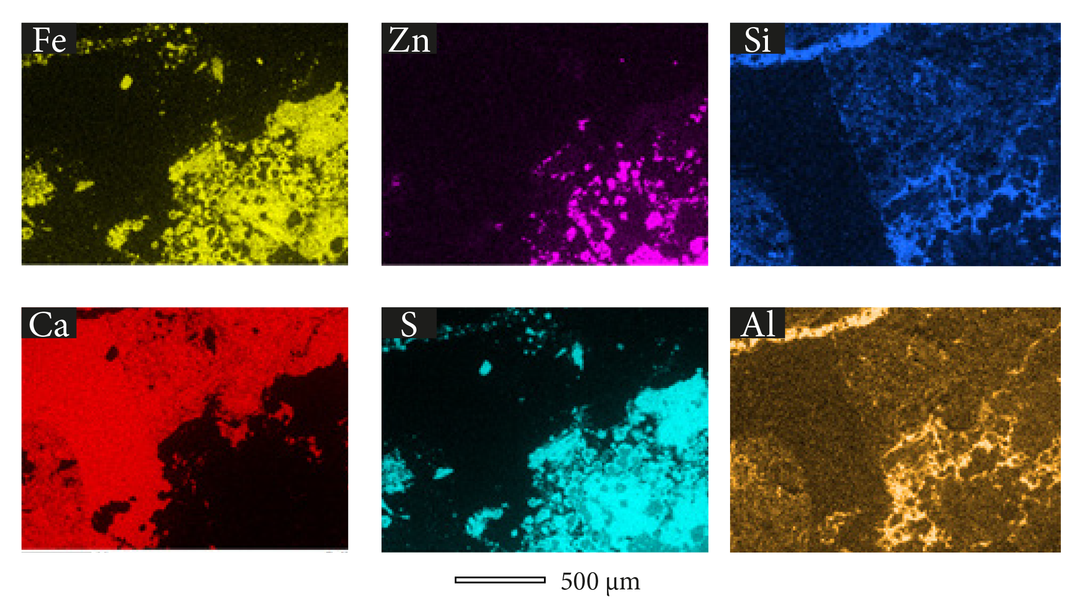

EDS images of crinoid ossicle
EDS images illustrating the elemental composition in the geological section containing the crinoid ossicle. When combined with Raman spectroscopy, the identities and distributions of these minerals are revealed.
