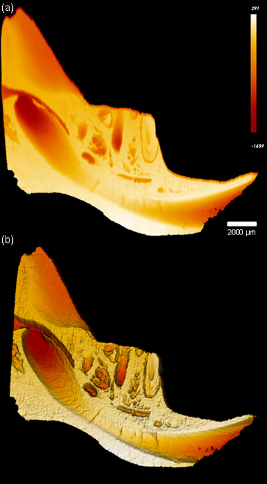

LiveTrack technology works with all of Renishaw's fast Raman imaging techniques. WiRE™ software can overlay Raman images onto 3D topographical views of the sample surface. The resulting 3D Raman mages can help you to understand how chemistry and structure relate to topography. You can also extract cross-sections of the samples in x- and y-planes for dimensional information.

Correlate surface topography with chemistry
Understand the structure and chemistry of ammonite fossils.
