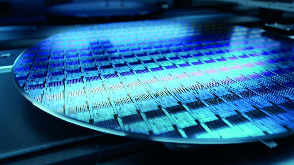

Semiconductor wafer during productionSemiconductor wafer during production
