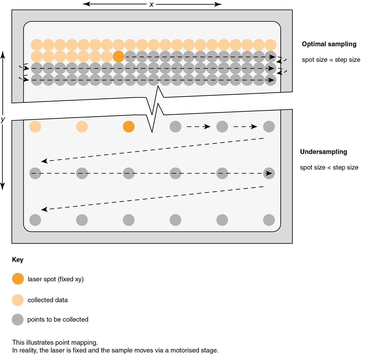

Undersampling
The relationship between the spot size and step size is a crucial aspect of sampling.
Optimal sampling occurs when these are equal. The whole area is covered without overlapping.
Undersampling occurs when the step size is greater than the laser spot size. This makes mapping faster but there are regions of our sample that have not been analysed.
