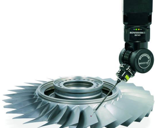

REVO inspecting blisk
REVO 5-axis measurement system inspecting blade profiles on a blisk.
