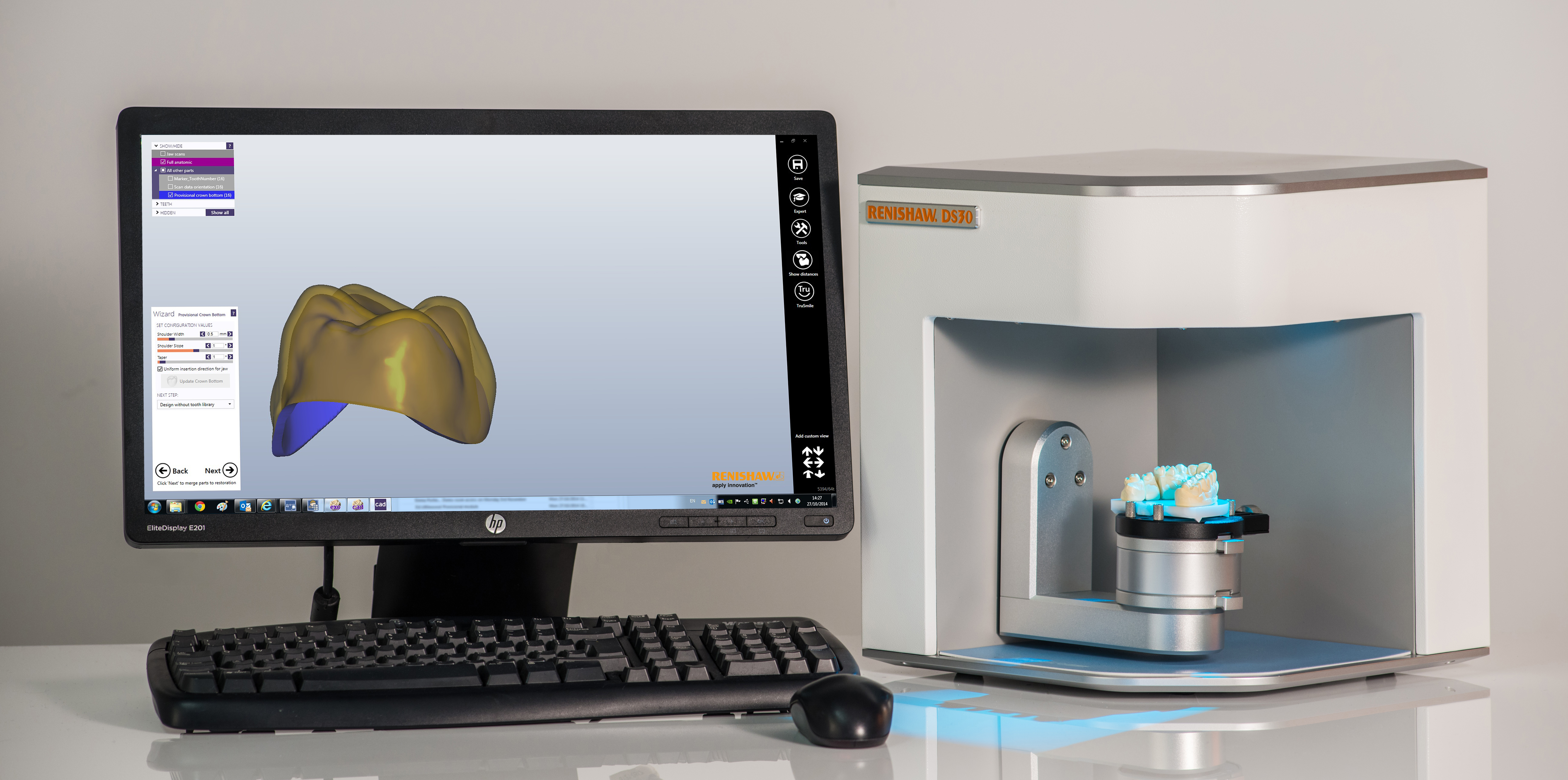

The AM250 is coupled with Renishaw's DS30 blue light scanner, which creates a digital copy of a dental impression or model. The dental frameworks are designed in Renishaw Dental Studio (RDS) and exported as 3D CAD data. These digital files are then sent to the AM250 and are produced from 40 micron layers of CE-marked cobalt chrome powder. Up to 300 dental frameworks, each with a unique ID tag, can be printed within eight to twelve hours.

DS30 scanner coupled with Renishaw Dental Studio (RDS) for design
