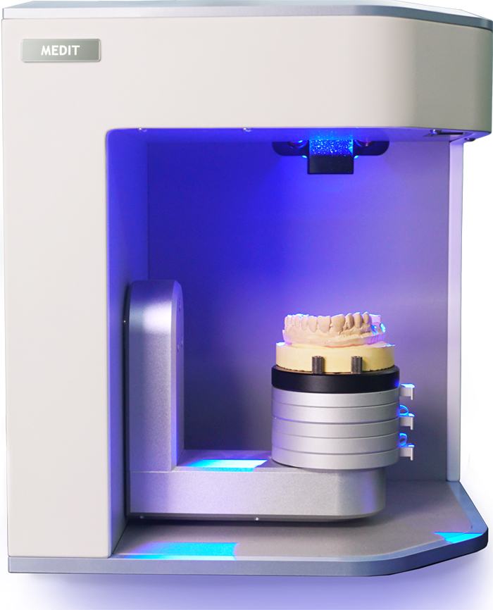

Take full advantage of Medit's T300 and T500 fast scanning times and adaptable nature to help streamline your laboratory's workflow and increase productivity.
High speed scanning
We supply and support Medit's T300 and T500 dental scanners, bringing flexibility, speed and accuracy to Renishaw's scanner line-up.

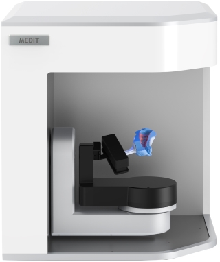

Intelligent multi-view allows the selection of the best possible angles to acquire the required data.
Impression scanning is fast and accurate, allowing the digital manufacturing process to proceed without the need of a conventional model.
Multi-die mode allows for the rapid creation of high volumes of shell copings.
