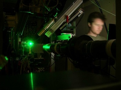

Custom Renishaw Raman probe interface deployed on the SNBL beamline
Part of the custom Raman probe deployed on the SNBL Beamline, ESRF, Grenoble, France.
