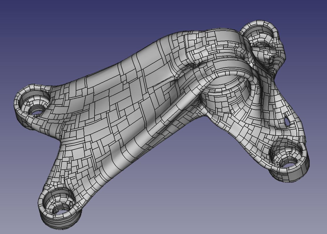

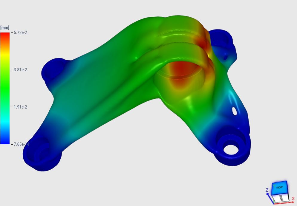

ParaMatters' CogniCAD cloud solution enables users to easily upload part geometries for optimisation and automatically produces lightweight macro, meso and lattice structures using generative design principles backed up with high resolution finite element analysis (FEA) validation. CogniCAD users are no longer constrained by traditional complex CAD/CAE/CAM tools, instead they simply upload their part and follow the intuitive CogniCAD workflow and user-friendly interface to prepare a printable model.

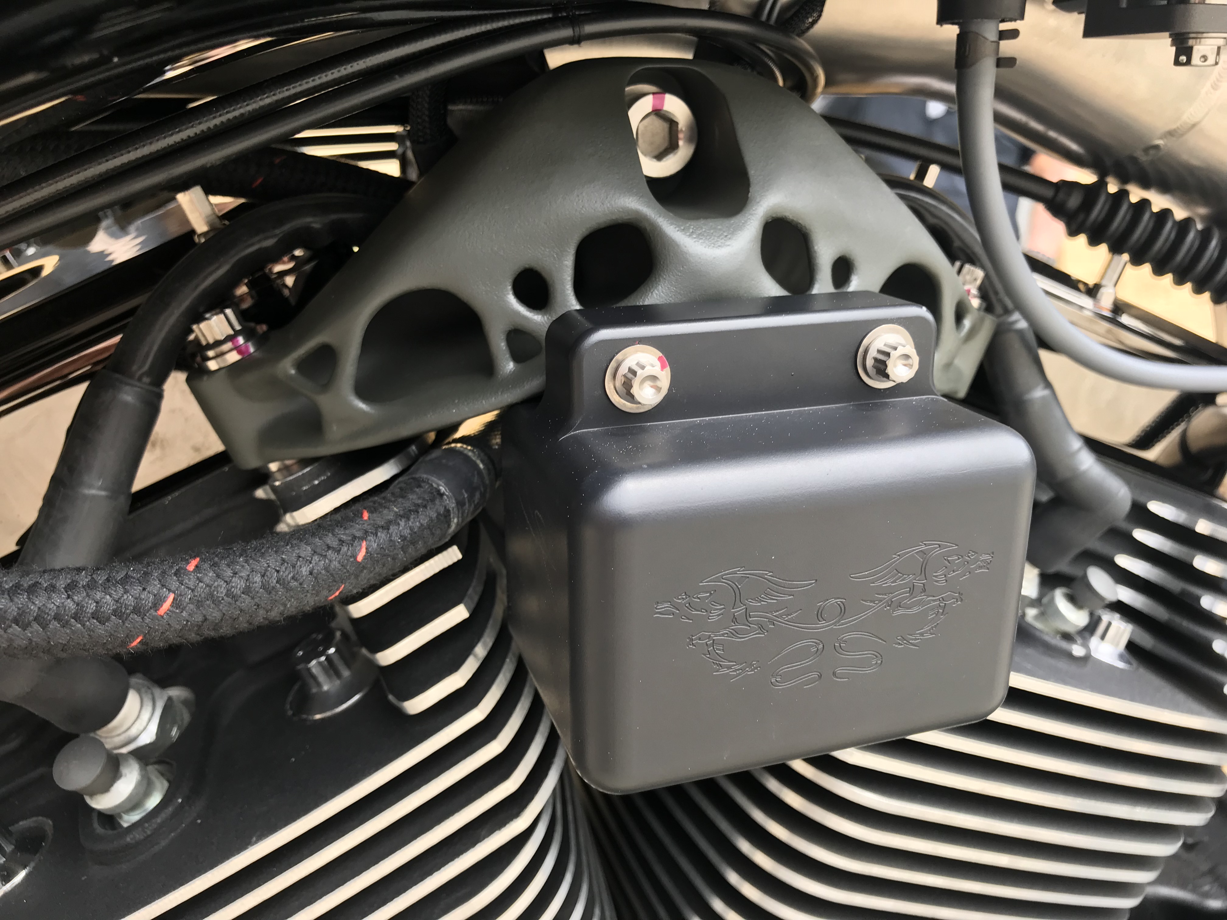

Renishaw has previously used CogniCAD to reduce the weight of the upper mounting bracket for ECOSSE Moto Works' motorcycle, the Nightstalker. Lightweight components are important in motorcycles for ensuring fuel efficiency and improved dynamics. Here, the two complementary technologies are used together to produce lightweight and structurally robust components and Renishaw's collaboration with ParaMatters has made both technologies accessible to its customers.
“We worked with Renishaw to establish a smooth workflow that made it possible to automate the entire process from design to manufacturing,” explained Michael Bogomolny, Co-Founder & CTO of ParaMatters. “CogniCAD uses topology optimisation, computational geometry and high-performance computing to autonomously generate designs that are adapted to make the best use of AM.”

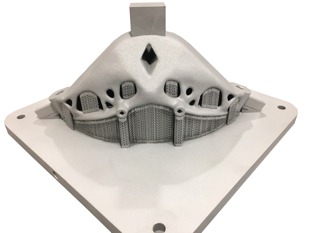

ParaMatters produced a design for the motorcycle bracket, which included a lattice structure to reduce the weight of the part. Once redesigned, the bracket's structural performance was validated using FEA, provided by CogniCAD, and assessed by fitting it onto the motorcycle. The results exceeded expectations. The final bracket was 35 per cent lighter than the original part, the maximum stress was 20 per cent less and the fundamental natural frequency of the part was two per cent greater.
