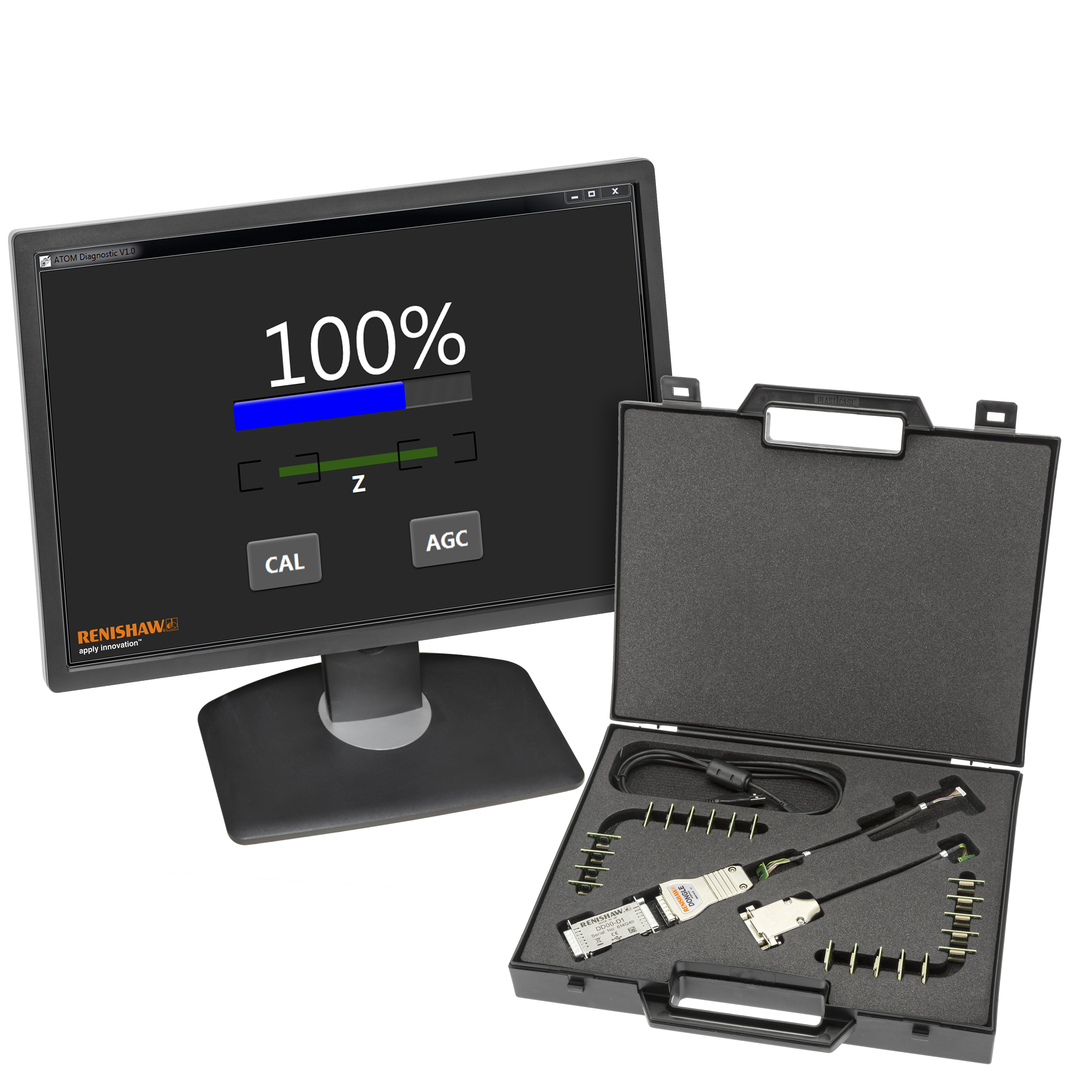

ATOM linear and rotary (angle) encoder systems feature integral set-up LEDs that are usually sufficient for installation purposes. Those customers with the most challenging set-up requirements are now supported by an optional PC diagnostic software package for use in conjunction with a diagnostic hardware kit. The software is particularly useful in situations where reliable visual assessment of the LED is difficult. ATOMs diagnostic software is available as a download and is simple to install and easy to use.
Renishaws ATOM diagnostic hardware kit is supplied in a convenient carry-case to enable interface between any ATOM readhead variant and a standard USB port. The diagnostic kit includes a diagnostic dongle and associated hardware, connectors and a USB cable. Once the ATOM readhead is connected to the diagnostic system, the customer can view the signal amplitude and confirm that the reference mark is correctly calibrated via a graphical interface - which also allows the user to remotely calibrate the system and toggle the AGC status. Alternatively, an audible tone can be output in cases where the visual display is obstructed during readhead adjustment.

Customers with the most challenging set-up requirements are now supported by an optional diagnostic software package for use in conjunction with a diagnostic hardware kit. The ATOM diagnostic kit is particularly useful in situations where reliable visual assessment of the LED is difficult. The diagnostic software is available as a download and is simple to install and easy to use.
