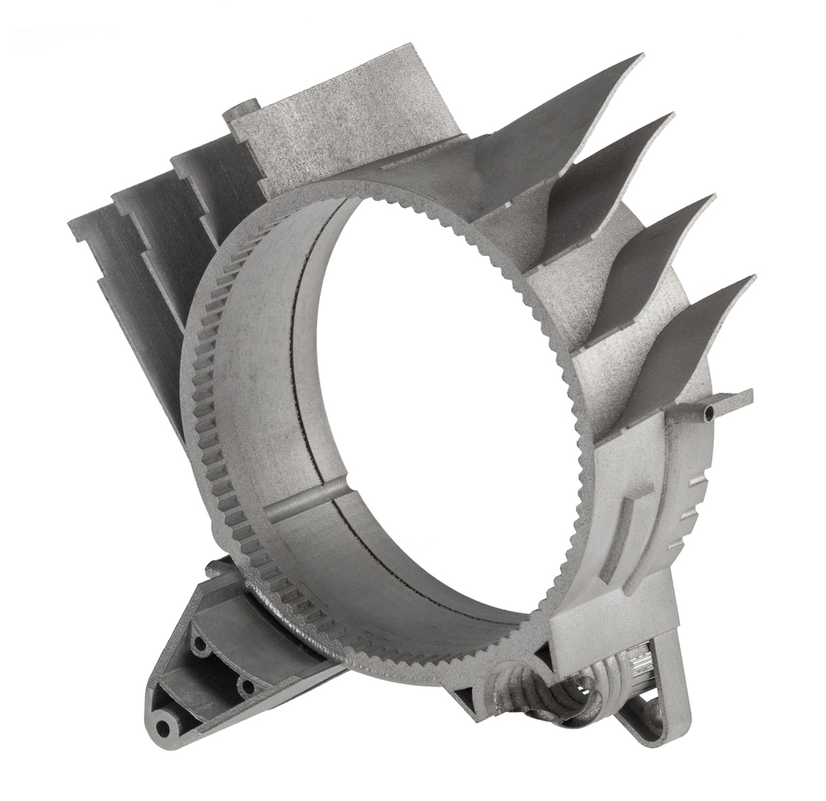

Laser melting systems
Laser melting system componentRenishaw will highlight for the first time at MACH its range of additive manufacturing technologies. On show will be Renishaw's laser melting systems, which utilise a pioneering, additive manufacturing process capable of producing fully dense metal parts direct from 3D CAD, using a high-powered fibre laser. Parts are built from a range of fine metal powders that are fully melted in a tightly controlled atmosphere, in layer thicknesses ranging from 20 to 100 microns.
