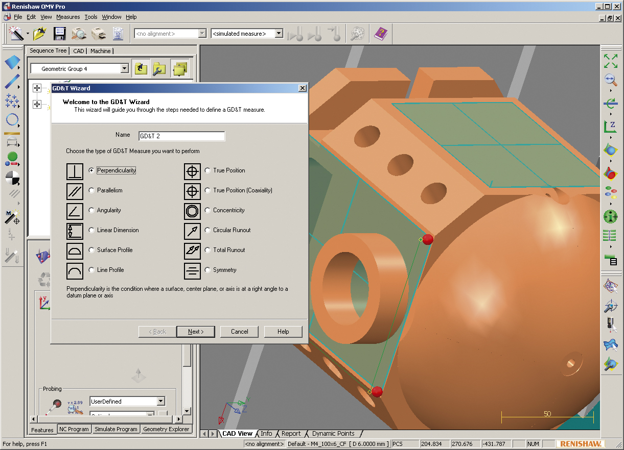

On-machine geometric measurement significantly enhanced with new measurement and reporting capability
Renishaw has also released a new version of its Renishaw OMV Pro software, a powerful package that works with touch probes to give advanced on-machine part verification and machine simulation capabilities. Now supporting Microsoft® Windows Vista®, Renishaw OMV Pro 2.02 adds more advanced co-ordinate measuring machine (CMM) style capability with an extended range of geometric dimensioning and tolerancing (GD&T) functionality, plus the ability to work with multiple alignments in a single program, useful for users of complex multi-axis machine tools. Like the more basic Renishaw OMV software, visitors to EMO Milan saw that the new version of Renishaw OMV Pro allows users of machine tool touch probes to quickly verify the accuracy of free-form and prismatic parts with a crystal-clear reporting format that makes the software accessible to shop-floor staff.

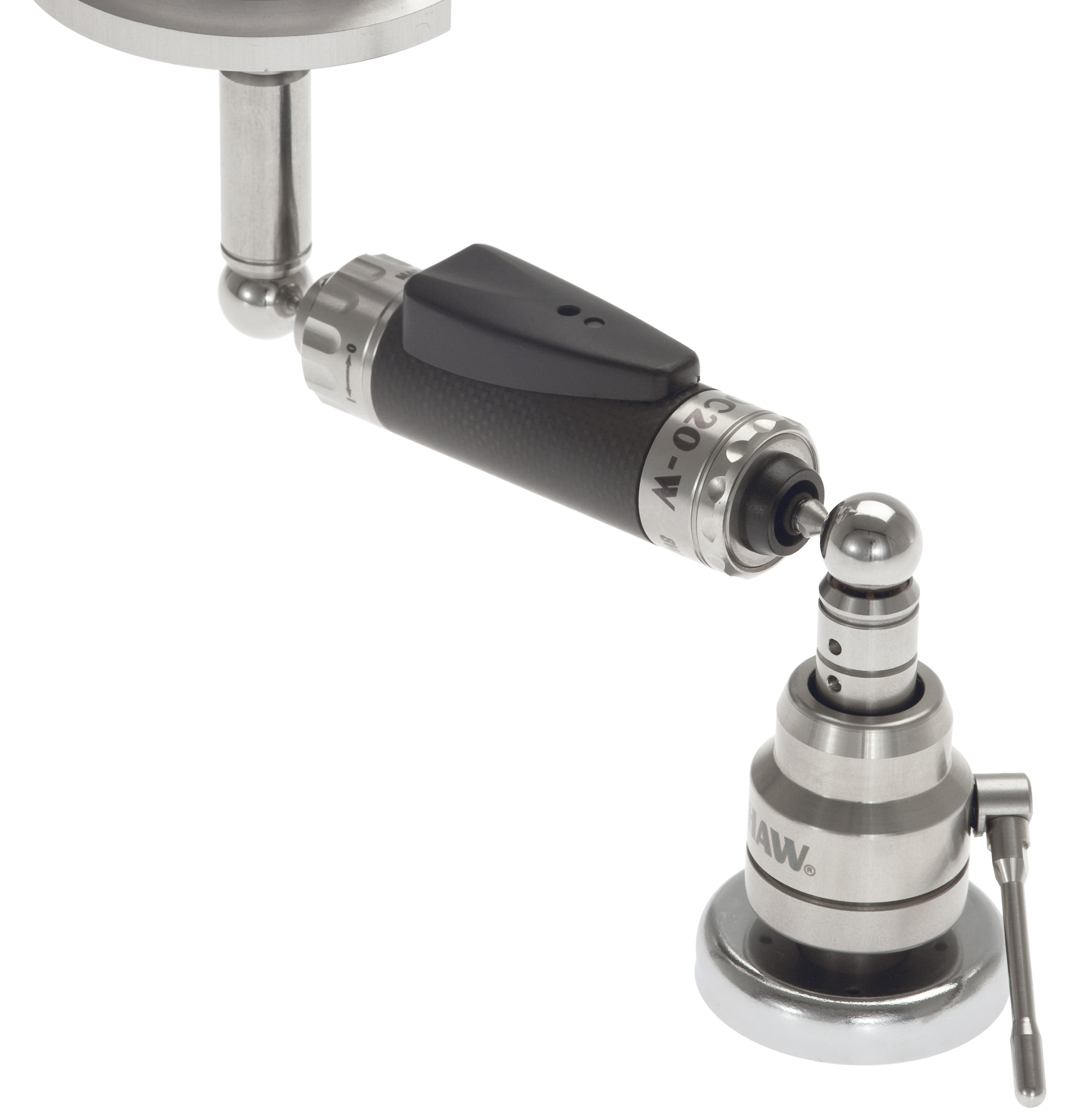

New wireless ballbar with volumetric testing capability
At EMO Milan Renishaw announced the launch of a successor to its well established QC10 ballbar system; a tool adopted worldwide for the assessment of machine tool positioning and servo control performance. The QC20-W ballbar is a completely new design featuring a Renishaw developed linear sensor and Bluetooth® wireless technology, which also allows testing in 3 orthogonal planes through a single reference point. A single, simple hardware set up means quicker testing and the ability to produce a representative volumetric measurement of positioning accuracy.
