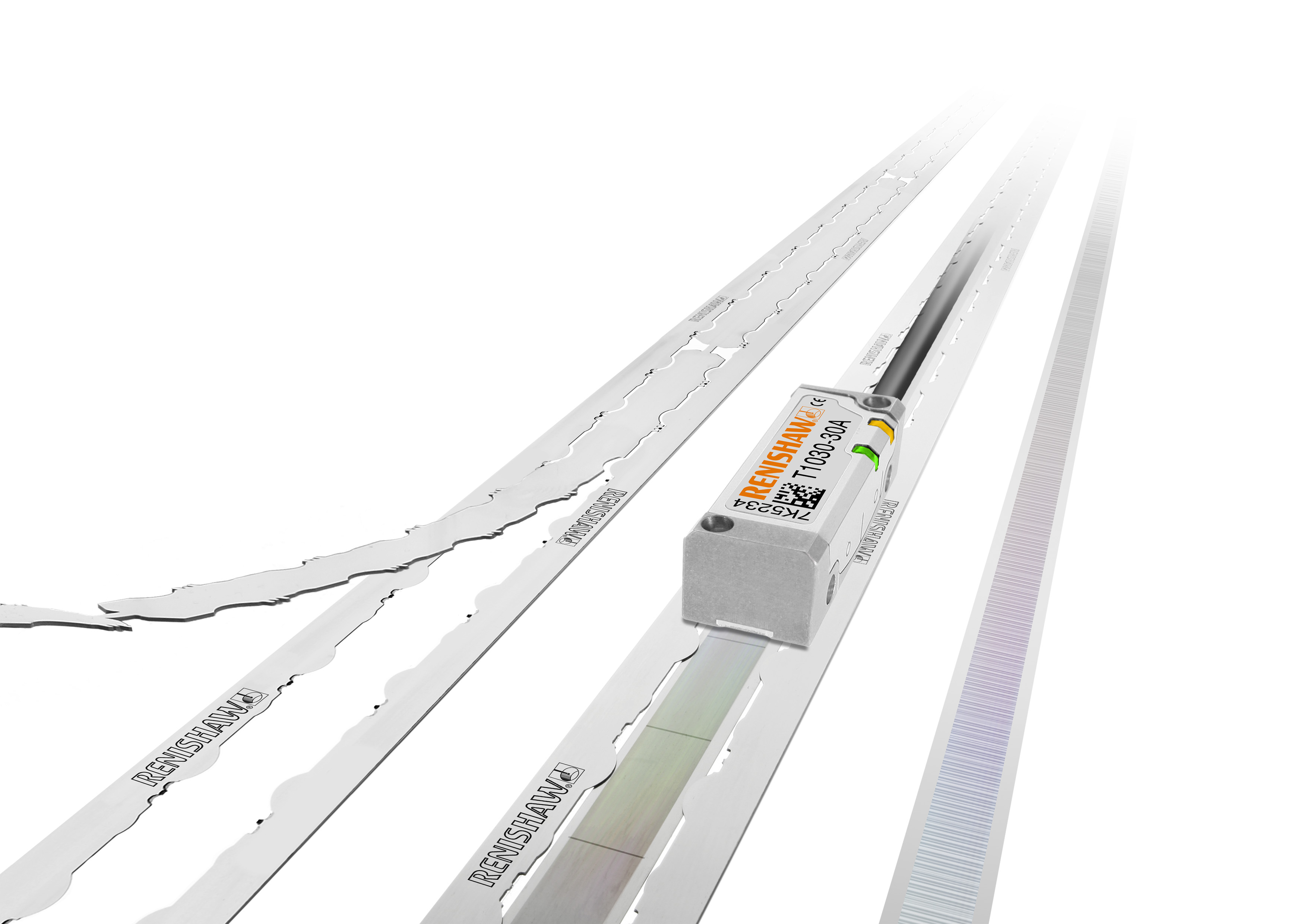

Linear encoder track scale
FASTRACK™ linear encoder scale with TONiC™ readheadFASTRACK™ is a revolutionary track-mounted linear encoder scale system that combines ±5 µm/m accuracy, with the ruggedness of stainless steel, and the quick and easy installation of a carrier-type encoder system. Designed for applications that demand high accuracy and easily removable scale, ATX visitors will see that the FASTRACK scale system consists of two miniature guide rails that securely retain Renishaw’s new low-profile scales and allow them to freely expand at their own thermal expansion coefficient with almost zero hysteresis. If damaged, the scale can be pulled out of the guide rails and quickly replaced, even where access is limited, thus reducing machine downtime.
