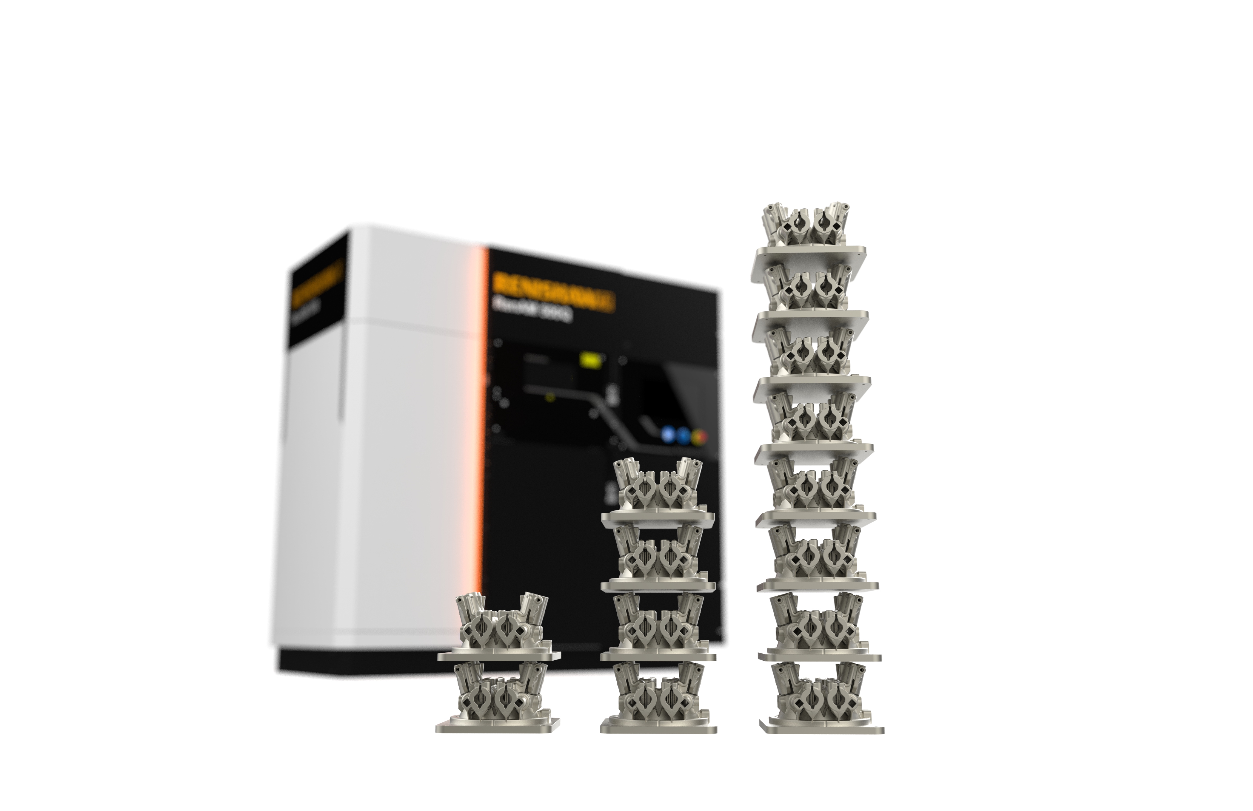

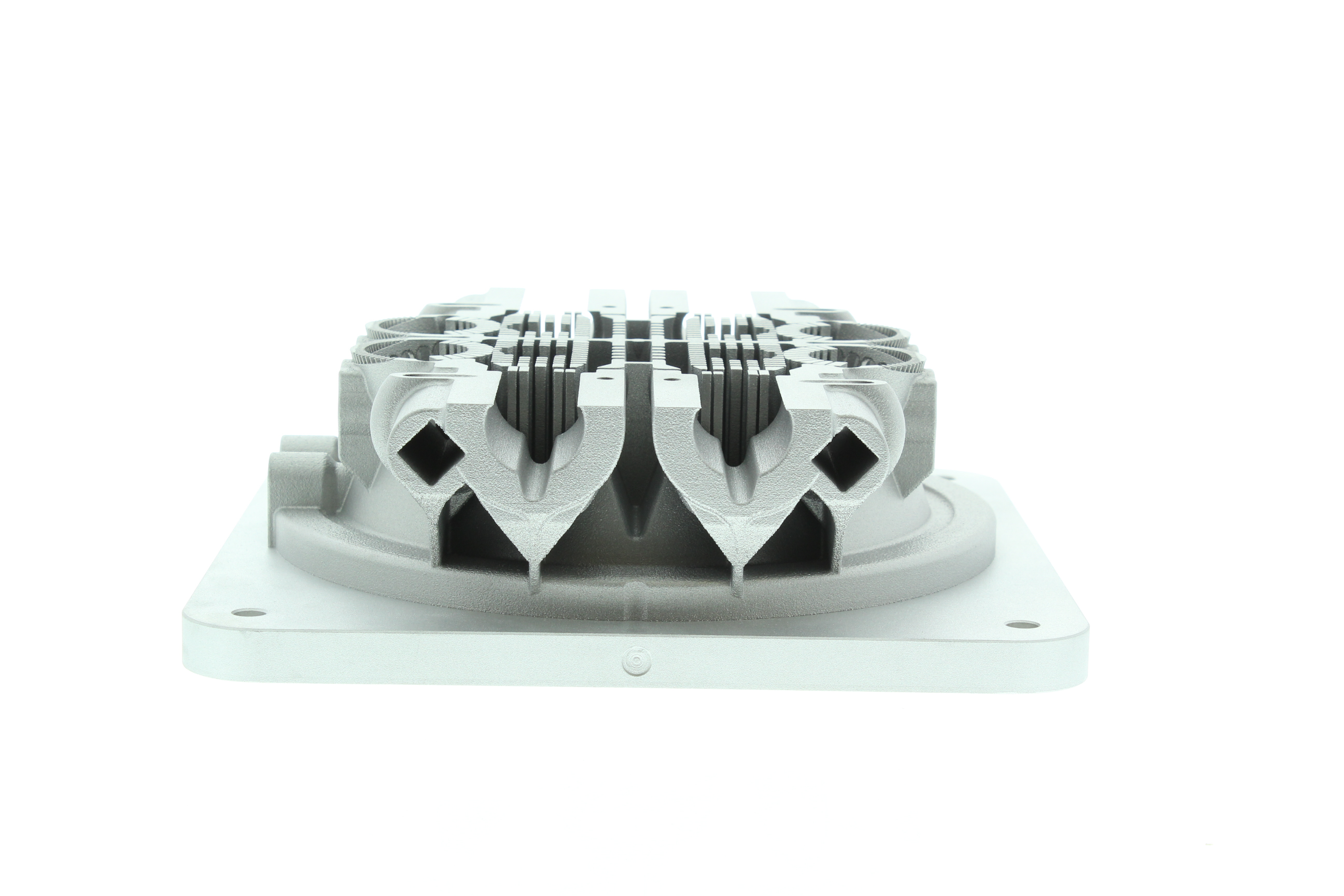

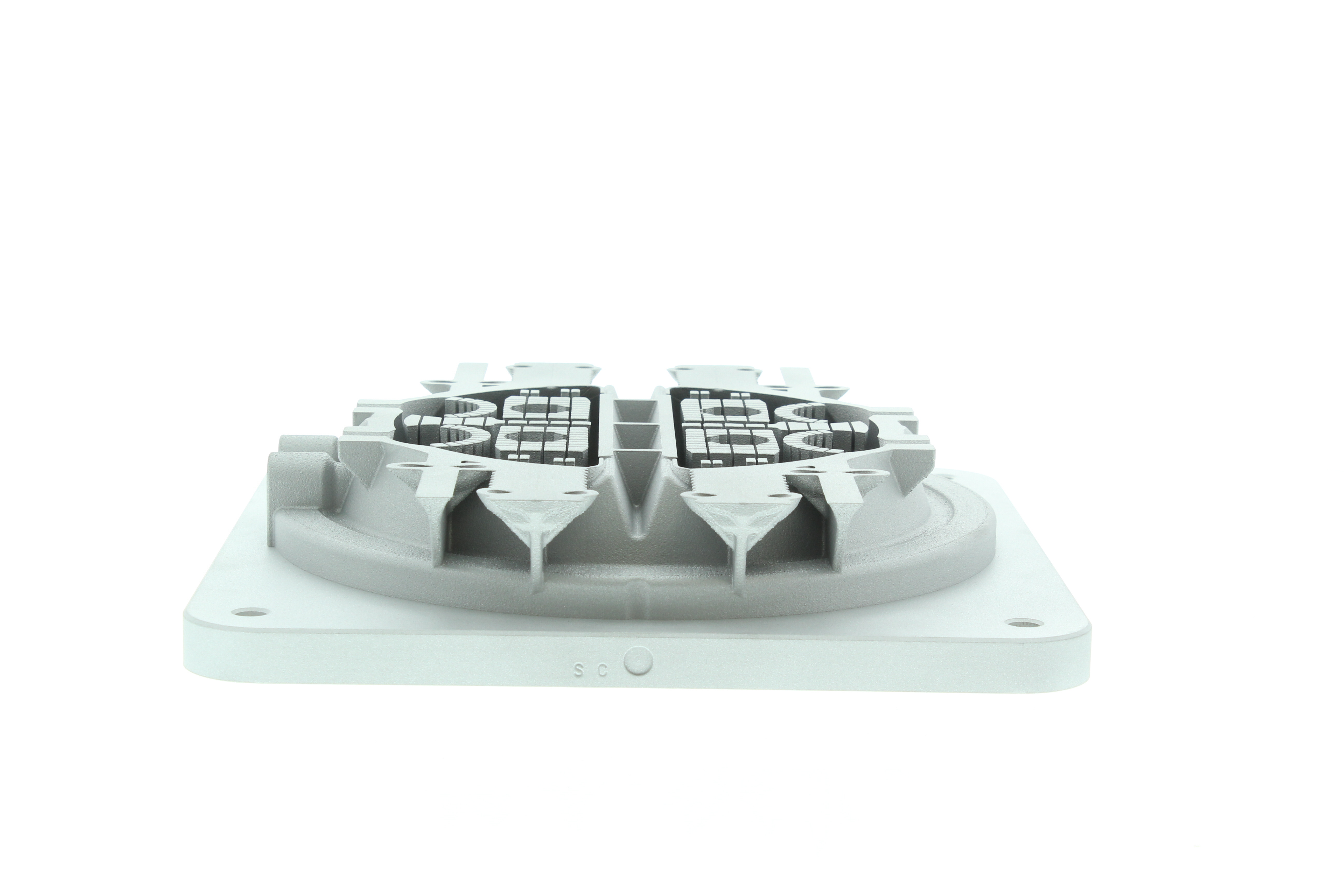

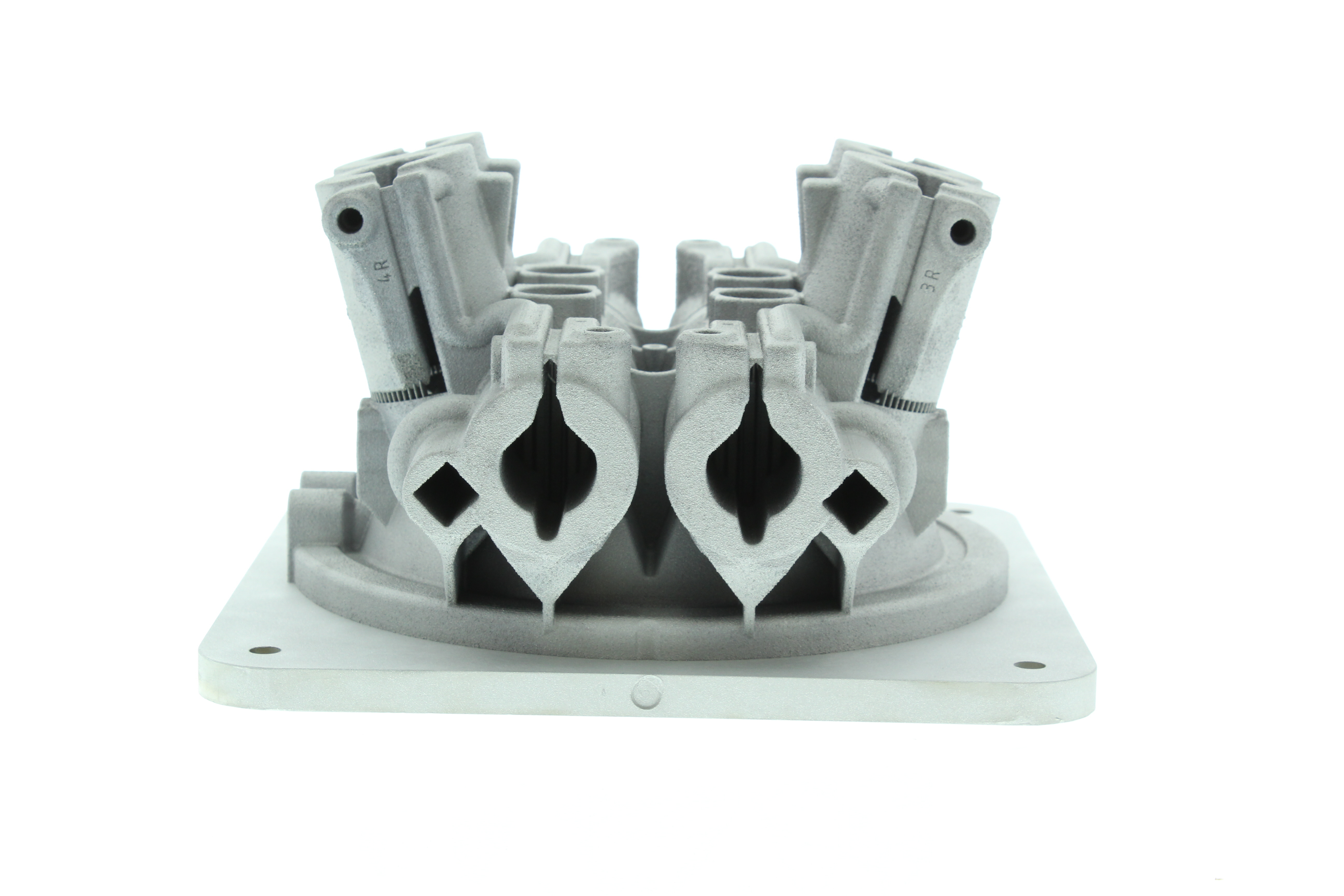

One example is the Renishaw RenAM 500Q galvo mounting block, which is additively manufactured in 19 hours using four lasers. It is an ideal AM part and an application where the operational demands are focussed on thermal stability, leak proofing and geometrical repeatability. It is not under significant structural load and so component testing can be confined to verifying functional design requirements.

- The galvanometer block additively manufactured using four lasers on the RenAM 500Q over a period of 19 hours [2.0MB]
- The galvanometer block additively manufactured using two lasers on the RenAM 500Q over a period of 19 hours [2.0MB]
- The galvanometer block additively manufactured using one laser on the RenAM 500Q over a period of 19 hours [1.5MB]
- Illustration of the galvanometer block production on the RenAM 500Q by number of lasers over a period of a week [1.3MB]
