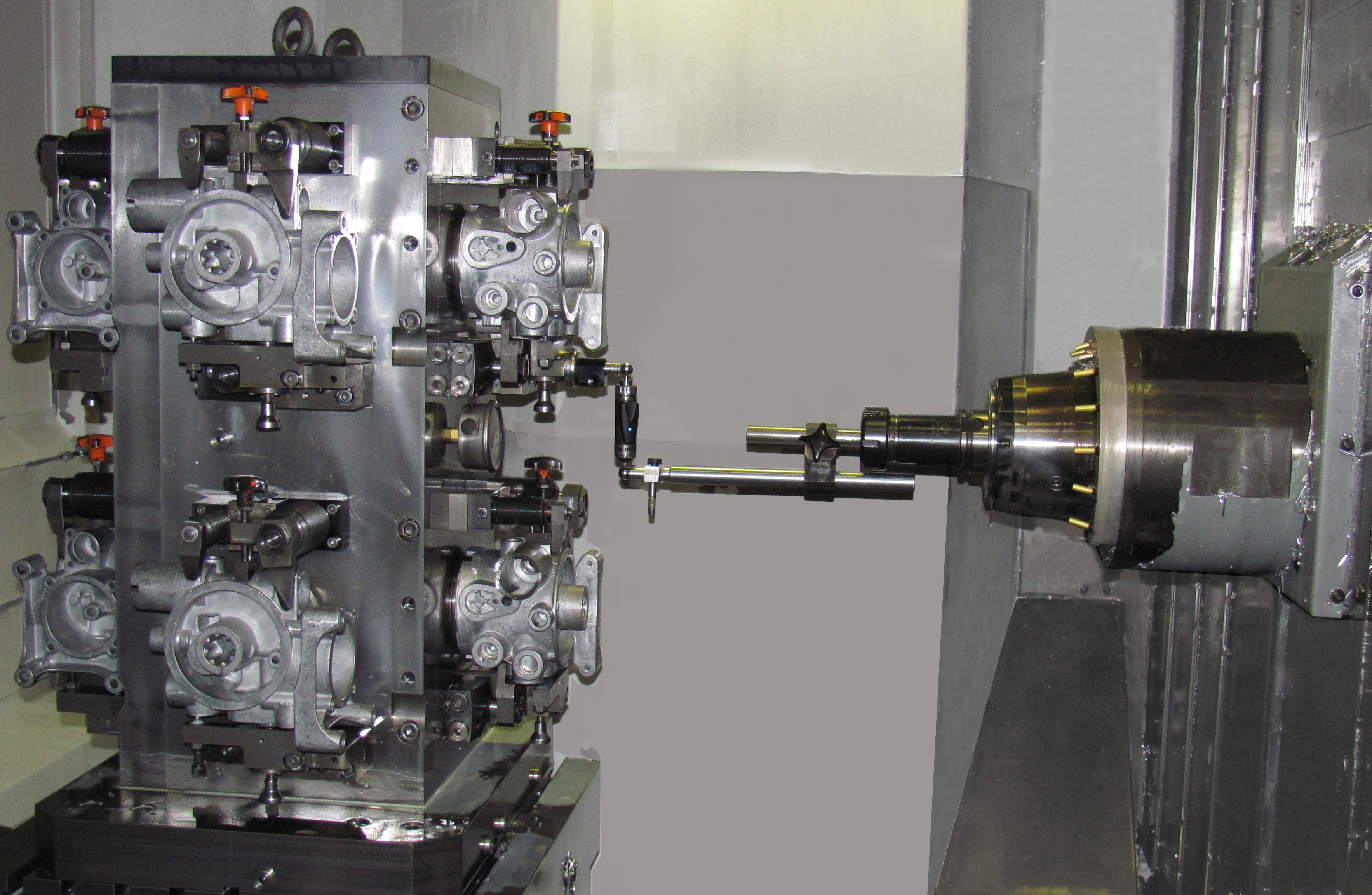

QC20-W test on large horizontal machining centre
Knorr-Bremse run a QC20-W test on a large HMC (Horizontal Machining Centre). Wireless design means that tests can be carried out with no risk of cables snagging on the workpieces.
