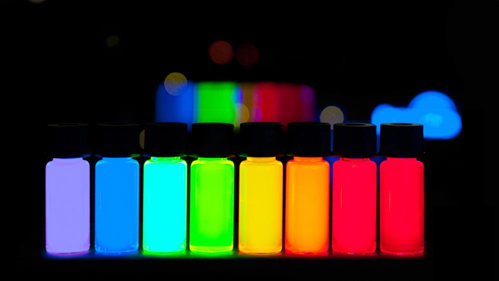

Quantum dots (editorial)
Quantum dots with vivid colours stretching from violet to deep red. Image © Alexei Antipov / Wikimedia Commons / CC-BY-SA-3.0 / GFDL
