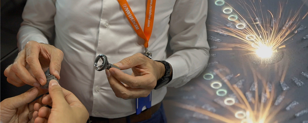

When searching for a new AM machine, we found ourselves looking closely at the Renishaw RenAM 500Q and it immediately struck us as a very interesting solution. This was down to several reasons, first and foremost the production area, which has impressive four sintering lasers. This feature allows us to achieve a remarkably higher level of production and a reduced cycle time per unit produced as compared with the single laser machines we already had in our workshop.

By speeding up the process by up to four times, the RenAM 500Q broadens the market appeal of metal additive manufacturing into applications that were previously uneconomic, driving the technology into new industries. The RenAM 500Q is designed to scale up AM technology to suit larger production volumes, enabling Permedica to use the system for mass production of standard parts instead of custom applications. Its working volume (250 x 250 x 350 mm) and four lasers enables the company to meet demanding production volumes and speeds. The system also features automated powder and waste handling systems that enable consistent process quality, reduce operator intervention time and ensure high standards of system safety.
Four 500W lasers enable RenAM 500Q to provide large volume production

By installing the RenAM 500Q, Permedica experienced increased throughput and found that the mechanical properties of parts manufactured on the machine were superior. This enabled the company to extend the production of other parts using AM. Permedica purchased two additional RenAM 500Q systems in 2022, allowing them to meet increased demand for mass produced medical components in the healthcare market.
