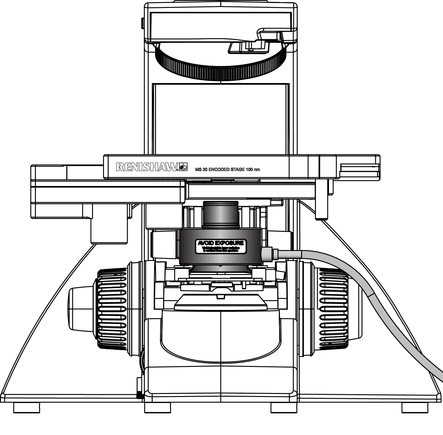

Transmission Raman spectroscopy with inVia
Obtain fast, quantitative analysis of bulk materials or see through coatings and containers with Transmission Raman.
Transmission Raman is a fibre coupled accessory which maintains all the functionality of the inVia.
  • Accurately establish the relative amounts of different components, from even very large samples (> 20 cm3)
  • Map large sample volumes to reveal blend homogeneity and material distribution
  • 785 nm and 830 nm excitation wavelengths available as standard (other laser frequencies on request)
  • Fibre coupled enabling the combined use of the laser in both transmission and backscatter configurations and the ability to automatically switch between modes
  • Enables transmission Raman mapping when combined with the Renishaw High Speed Encoded Stage (HSES)
  • Focused or collimated illumination beam up to 6 mm in diameter and a variety of collection optics available on request
