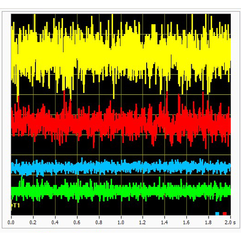

Figure 2 shows a comparison of jitter performance with feedback from the RESOLUTE encoder and the alternative ultra-fine pitch system. Standard PID control clearly highlights the lower jitter performance of the ultra-fine pitch system, with measured jitter values of 6.84 nm RMS (yellow) for the RESOLUTE encoder and 3.98 nm RMS (red) for the alternative encoder. The net effect of ServoBoost™ is to significantly reduce the difference and magnitude of these values to 1.91 nm RMS (green) and 1.46 nm RMS (blue), respectively. Evidently, powerful control algorithms compensate for much of the jitter performance disparity between these two encoder systems.

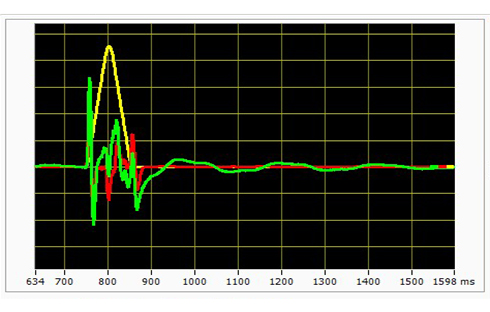

Figure 3 shows that in terms of move and settle times or tracking errors there is also significant improvement. The yellow profile gives the velocity profile (100 mm/sec per division) input required to command the servo-stage to change and hold position, whereas the green and red graphs give the position errors (2 microns per division) seen with standard PID and ServoBoost™ control, respectively. Advanced control algorithms significantly improve settling error and performance and eliminate the damped oscillations seen immediately after the command to hold position in the PID control case.

Renishaw, in collaboration with ACS, has shown that advanced controller software such as ServoBoost™ enables better, more consistent servo performance and allows a significant reduction in settling position error when compared with standard proportional integral-derivative (PID) control algorithms. Tests by ACS, in collaboration with Renishaw, on a crossed roller-bearing linear stage equipped with a 1 nm resolution RESOLUTE encoder and an ultra-fine pitch alternative product show that, when the RESOLUTE encoder feedback is combined with ServoBoost™ control, effective jitter drops below 2 nm RMS which is equivalent to high-end fine pitch encoders.Comparison over time of jitter performance with feedback from the RESOLUTE encoder and an ultra-fine pitch competitor (cropped)Figure 2: comparison over time (s) of jitter performance with feedback
from the RESOLUTE encoder and an ultra-fine pitch alternative

Figure 3: comparison over time (ms) of move and settling with feedback from the RESOLUTE encoder and an ultra-fine pitch alternative
