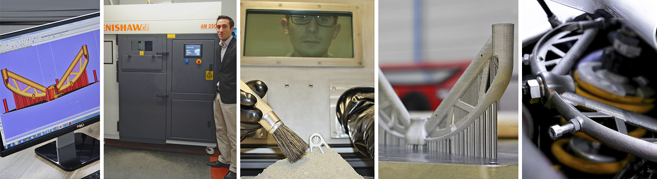

TransFIORmers' original wishbone component was hand-fabricated in steel, with the assembly comprising of twelve separately machined and welded parts. I3D Concept consolidated the design into a single piece component, greatly reducing assembly time.
The company produced the metal 3D printed wishbone using a Renishaw AM250 additive manufacturing system; initially prototyping in stainless steel (inox) and finally manufacturing a lighter weight part in titanium.
Key to the new 3D component design was an iterative process of topological optimisation, whereby the wishbone layout was successively rationalised in software within tight space constraints to withstand a set of predefined front fork loading conditions.
TransFIORmers topological software
Wishbone component in CAD software
Once the final component design was validated using digital CAD software, the build preparation file was prepared offline prior to export to the additive manufacturing system.
Within the CAD software, I3D Concept was able to assess whether the parameters were effectively predetermined or whether they required tweaking to match the specific metal powder characteristics and the complex target geometries of the TransFIORmers wishbone.
Importantly, using the AM250's dedicated Optical Control System (OCS) software, I3D Concept was able to very accurately control laser steering which helped to enhance precision, definition of features and surface finish.

By taking an additive manufacturing approach to Moto2 bike design, TransFIORmers succeeded in dramatically reducing the weight of its critical wishbone front suspension component by a factor of 40%. Comparing the one-piece titanium component with the original welded steel component, a weight saving of 600 g was achieved.
New TransFIORmer wishbone
Metal 3D printed 1 part titanium component
Metal 3D printing has also provided TransFIORmers with much finer control over component tolerances and the flexibility to very quickly iterate wishbone geometries to match specific chassis and kinematic requirements.
“The weight reduction that metal 3D printing has achieved for us in our wishbone component has enabled us to bypass traditional weight transfer phenomenon and the problems associated with ‘brake dive'. More than that, it's allowed us to design a part that is not only lighter, but far more rigid at the same time,” explains Jérôme Aldeguer, Mechanical Engineer, TransFIORmers.
With an ultimate tensile strength in excess of 1100 MPa when processed using additive manufacturing, and near perfect 99.7% densities, the titanium Ti6AI4V alloy used has delivered a radical new wishbone offering far greater rigidity than the original multi-part, hand-assembled steel component.
