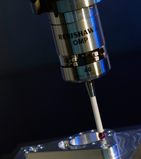

Starting with the premise that for the medical parts he intends to make, accuracy and process consistency are more important than complexity, Blowick took advice and invested in a small but capable Schaublin 48V mill fitted with a Renishaw OMP40 touch probe. He then took the bold decision to go further, purchasing GibbsCAM®, to turn his 3D designs into machining programs, Renishaw's Productivity+ probing software, to automate the programming of probe routines, and Renishaw's CNC reporter, an SPC package used to analyse and control the production process.
“Frank Boston from Schaublin Machine Tools supplied the machine, together with the probe system from Renishaw. He introduced me to Guy Brown from GSPS (www.gspsltd.co.uk), to set up the purchased software packages, configured for the Schaublin 48V.
Integrated software to automate the whole process
Guy Brown installed Renishaw's Productivity+™ plug-in for GibbsCAM to integrate the generation of probing cycles with the creation of metal cutting tool paths within the Virtual Gibbs package. A complete metal cutting process can be defined and simulated prior to machine prove-out. Simulation provides graphical identification of the work piece and shows any potential fixture collision with cutting tools. Productivity+ seamlessly adds the probe moves into the simulation, so that the whole process is developed off-line. The net result for Ray Blowick is short, reliable prove out times.
“The touch probe measures the part during the production cycle, the great thing about it being the way the Productivity+ routine updates the tool offset. I know I can get a precision part every time, with the system automatically controlling itself. The measured data is also recorded by CNC Reporter, providing feedback to adjust the process and keep it within control limits. That's the kind of confidence I need to put some of these new ideas into production.”
“Guy and Frank helped me make a calibration part incorporating most of the features I'd be likely to machine. I know exactly what I have to do and the tools are all set up in the library, so I use it and don't need to mess around with it or change it. The probing moves are in there to control the process but also to verify the finished parts - if there is any variation that can be fed back to the CNC control. I can also get a print out for the QA people or for my own records.”
Clada Medical - OMP40 probe measuring features
