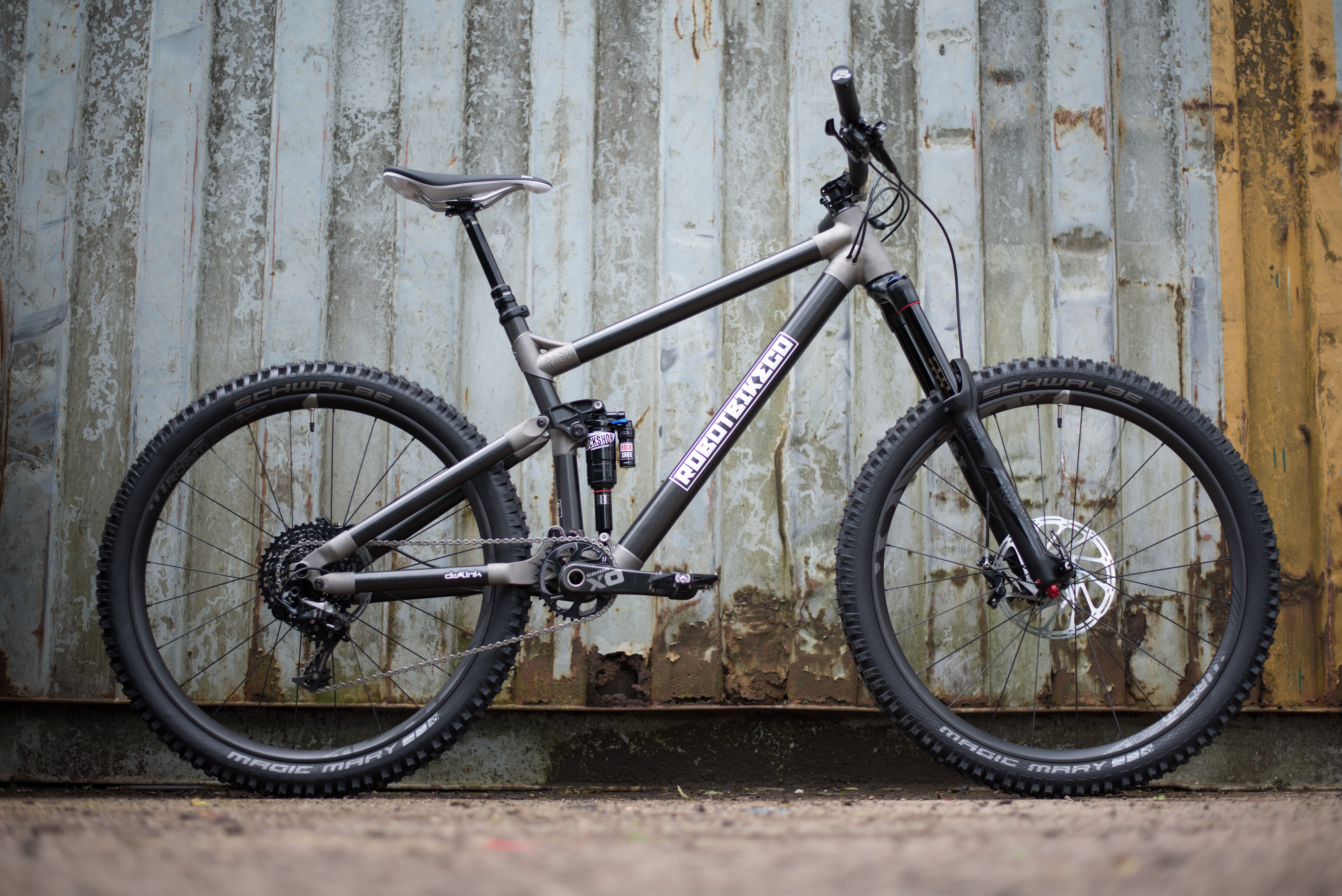

Now a new company, Robot Bike Co, has taken this a step further, combining cutting edge technology and anthropometry to create a bespoke and highly engineered MTB frame.
The R160 bike features a unique construction using additively manufactured titanium lugs, carbon fibre tubing and a double lap joint bonding concept. Featuring internal cable runs, the frame design also includes a full rear suspension structure, exclusively designed by Dave Weagle, as well as front-, seat- and top-tubes.
Most high-end MTB frames are made from carbon fibre, but these are restricted to a few different sizes due to the high cost of tooling. By contrast, the flexibility of AM to make customised parts means that each R160 frame can be tailored to a customer's individual measurements and specifications. Furthermore, the frame can be constantly improved as new technologies emerge, since the production process is not constrained by a mould.

Robot Bike Co's innovative MTB frame design results from a collaboration with Altair, HiETA Technologies and Renishaw. Each partner has brought its unique expertise to the project.
Robot Bike Co
Robot Bike Co developed the bike concept and worked with Dave Weagle to create the unique dw6 suspension with its progressive leverage ratio. The customisation capability of AM enables all aspects of suspension performance - ride, grip, and pedalling characteristics - to be individually tuned to suit the rider's preference.
