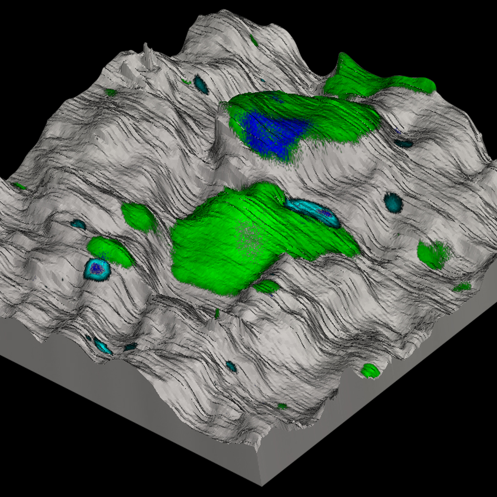

Generate images rapidly
Rapidly generate images of your formulations with StreamLine™. This uses line focus illumination, allowing you to use higher laser powers without risk of sample damage, thereby reducing experiment times.
With the RA802 pharmaceutical analyser you can achieve imaging speeds of over 1500 spectra/s. It takes less than 2 minutes, from placing a standard tablet in the system, to generate a full, high resolution Raman image.
Generate images of formulations
Ensure your chemical images are representative; use Renishaw's StreamLine. You can change resolution to suit your domain size and, because Renishaw's WiRE software can cope with massive data files, you can analyse over the entire sample surface. Powerful Renishaw features, such as Slalom (to ensure the whole surface is sampled) and HD imaging (to get crisp clear images), provide all the options you need, whatever your formulation.
