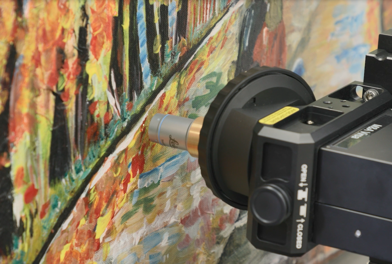

Raman spectra and microscope images from an acrylic painting
Raman spectra and microscope images from an acrylic painting illustrating a variety of modern pigments. Good spectral matches were found using a freely available spectral library.

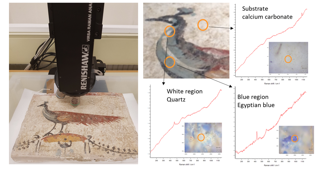

The Virsa™ Raman analyser examining a peacock fresco from Pompeii
(A) The Virsa™ Raman analyser examining a peacock fresco from Pompeii, at the Victoria and Albert Museum in London, UK. (B) The peacock fresco with areas highlighted for Raman analysis. (C), (d) and (E) Labelled Raman spectra and optical images from specific regions of the fresco.
