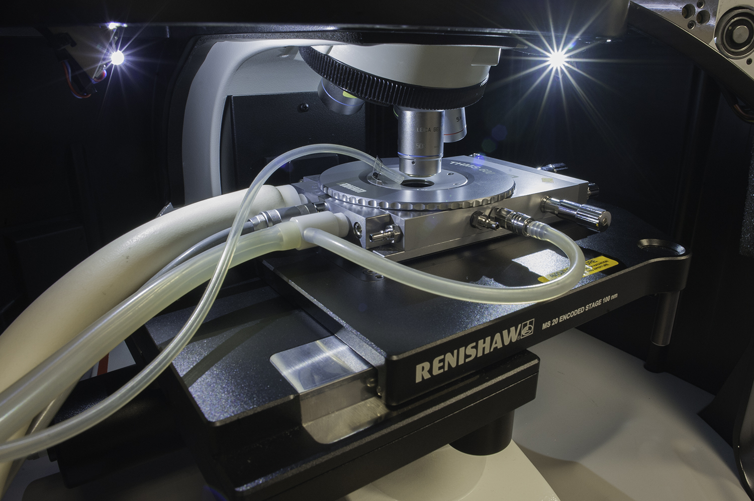

Renishaw supplies a wide range of cells, including:
  • temperature control stages - heating and cooling stages covering temperatures from 2.2 K (-271 °C) to over 1800 K (1500 °C)
  • cell incubators - precisely control the environment of live cells during Raman analysis
  • humidity cells - for studying the effect of humidity on materials such as drugs
  • electrochemical cells - for studying in situ corrosion, surface enhanced Raman scattering, etc
  • high pressure cells - diamond anvil cells for compressing samples to 50 GPa (500 kbar)
Other cells, such as catalytic cells and tensile testers, are also available. Contact us to find out more.
Temperature control cells
Choose from:
  • hot cell (ambient to 1500 °C)
  • hot-cold cell (-196 °C to 600 °C)
  • liquid nitrogen cell (77 K to 500 K)
  • liquid helium cell (2.2 K to 500 K)
