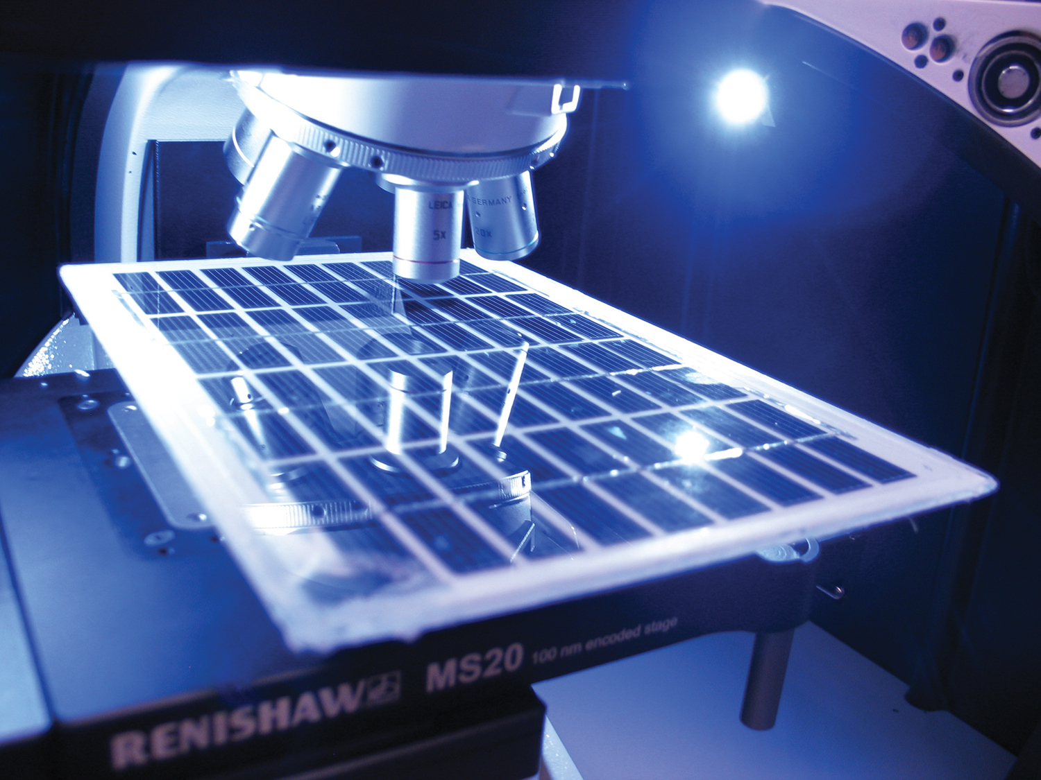

Analyse the final device to determine the effect production processes have on quality and performance. Renishaw offers a range of options to accommodate devices of different sizes. For the largest requirements, we specialise in producing free-space microscopes and bespoke solutions. These can be used to perform complete module analysis.

It is important to select an appropriate laser wavelength when analysing a material. An incorrect choice may cause damage, or result in the generation of data from too deep or too shallow in the sample. The inVia confocal Raman microscope makes it easy to use the best laser; you can equip it with multiple lasers and use its automation capabilities to switch between them in seconds.

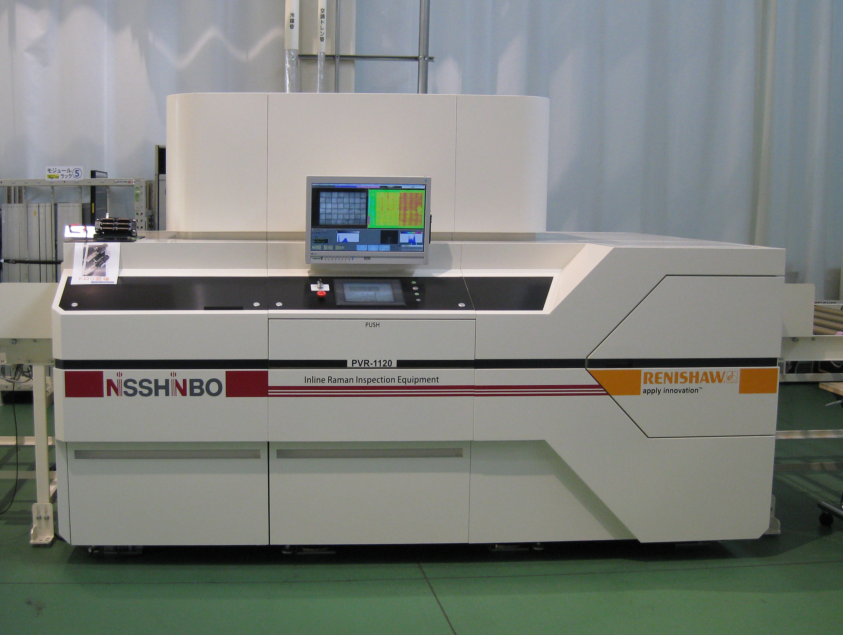

Online systems
Renishaw has provided numerous custom Raman systems for online quality control purposes.
