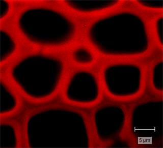

The thickness and distribution of the woody cell wall materials—cellulose, hemicellulose and lignin— are important factors for determining the strength of a plant. Raman imaging of cell walls is one of the only techniques that can be developed into an in-situ lignin and cellulose characterisation and quantification method. It does not require maceration of the materials or any wet chemistry and has the spatial resolution to resolve the thin lignin layer (sub-micrometre). An increase in lignin content is normally related to increased strength, with more guaiacyl lignin at the cell wall, and more syringyl lignin at the junction between the cell walls.
Pectin can also be Raman imaged. In terrestrial plants, it is found in the cell walls and is the major component in the middle lamella keeping cell walls together.
You can also study cellulose fibres, including their orientation (using polarised Raman measurements). The orientation is important because the angle of the microfibril affects the cell geometry and the plant's architecture.
Raman image of maize internode secondary cell walls (red) and the syringyl lignin (blue). Sample courtesy of Dr. Gordon Allison and Mr. Alan
Cookson, Aberystwyth University, UK.
