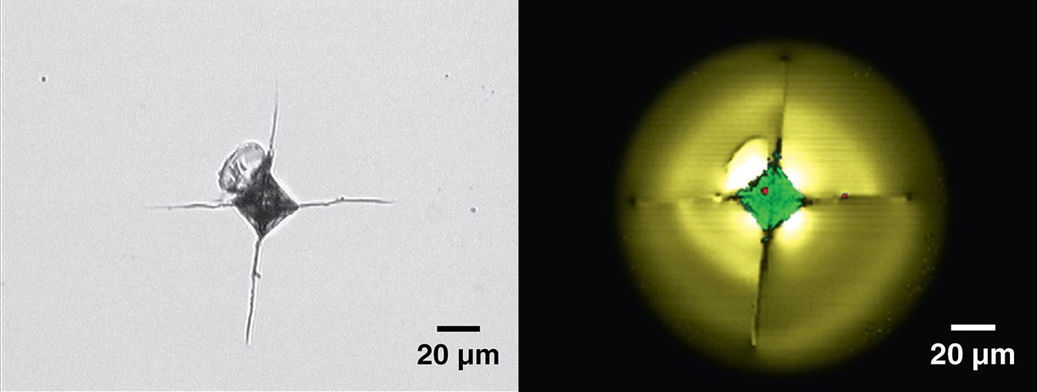

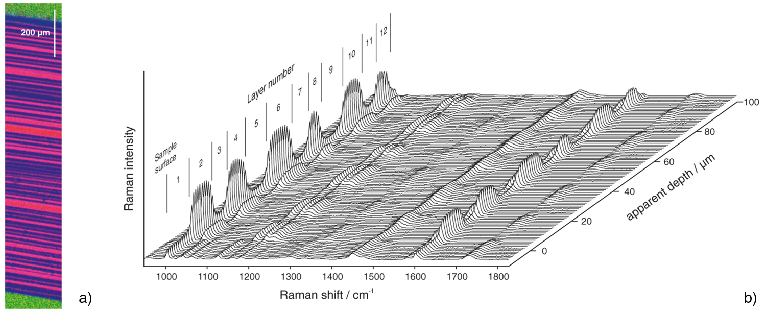

  • the thickness and composition of layered materials, such as polymer laminates, from micrometres to millimetres thick
White light and Raman images of washing powder
White light and Raman images of washing powder. The Raman images show chemically different domains which are not visible in the white light image.

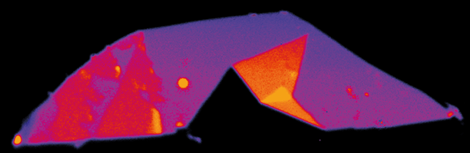

SiC wafer
Raman image of a SiC wafer. The images area is approximately 1 mm2, and shows inclusions of 6H-Silicon carbide, 3C-Silicon carbide or Si (red), voids (black). The strain distribution is shown as blue to green.
