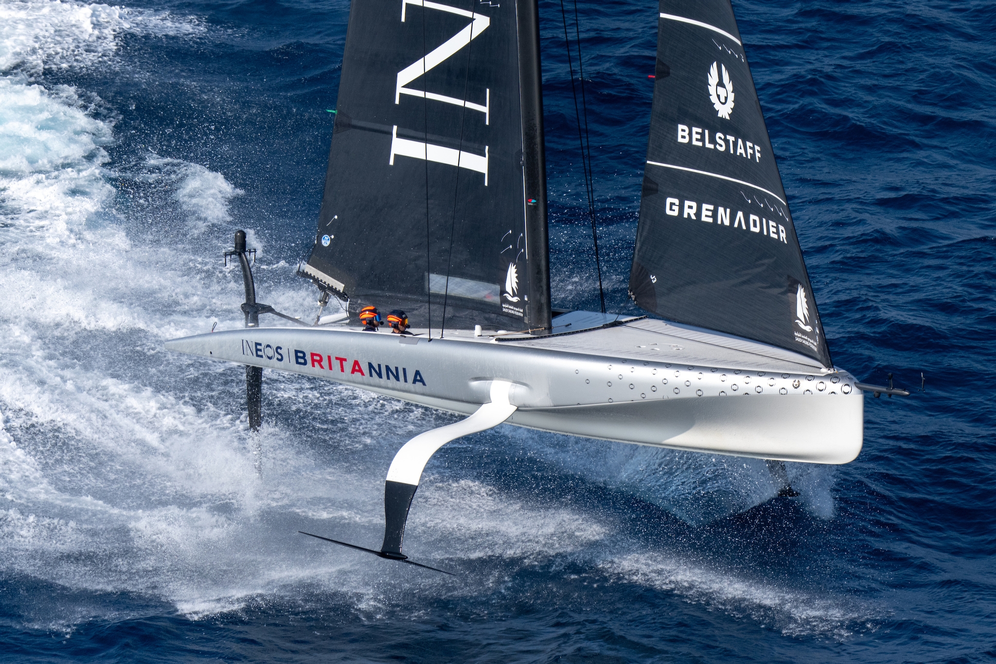

INEOS Britannia - sailing towards a sustainable future with AM
Renishaw, the global engineering company, is an official technical partner of the British sailing team, INEOS Britannia, which is the Challenger of Record for the 37th America's Cup.
Led by former Olympic champion Sir Ben Ainslie, the team will attempt to become the first British yacht to win the America's Cup in its 173-year history. The competition takes place in Barcelona, Spain, between August and October 2024.
Renishaw has supported the British challenger for the America's Cup since 2016. For the current campaign, Renishaw supplies INEOS Britannia with magnetic encoder solutions and additively manufactured parts, plus expertise in position measurement and Raman spectroscopy.

Reduced package weight can save both material costs and improve the environmental footprint associated with component manufacturing. Advanced composites are widely used on the AC75 Class boats to minimise weight. Renishaw has supplied INEOS Britannia with custom-designed rotary sensors (twist grips), featuring built-in magnetic encoders, that have been integrated into the race boat's helm controls.
These sensors are smaller and lighter than in previous campaigns due to electronic improvements that miniaturise the encoder - minimising the space needed for the helm and flight controls and enabling better ergonomics for the sailors.
