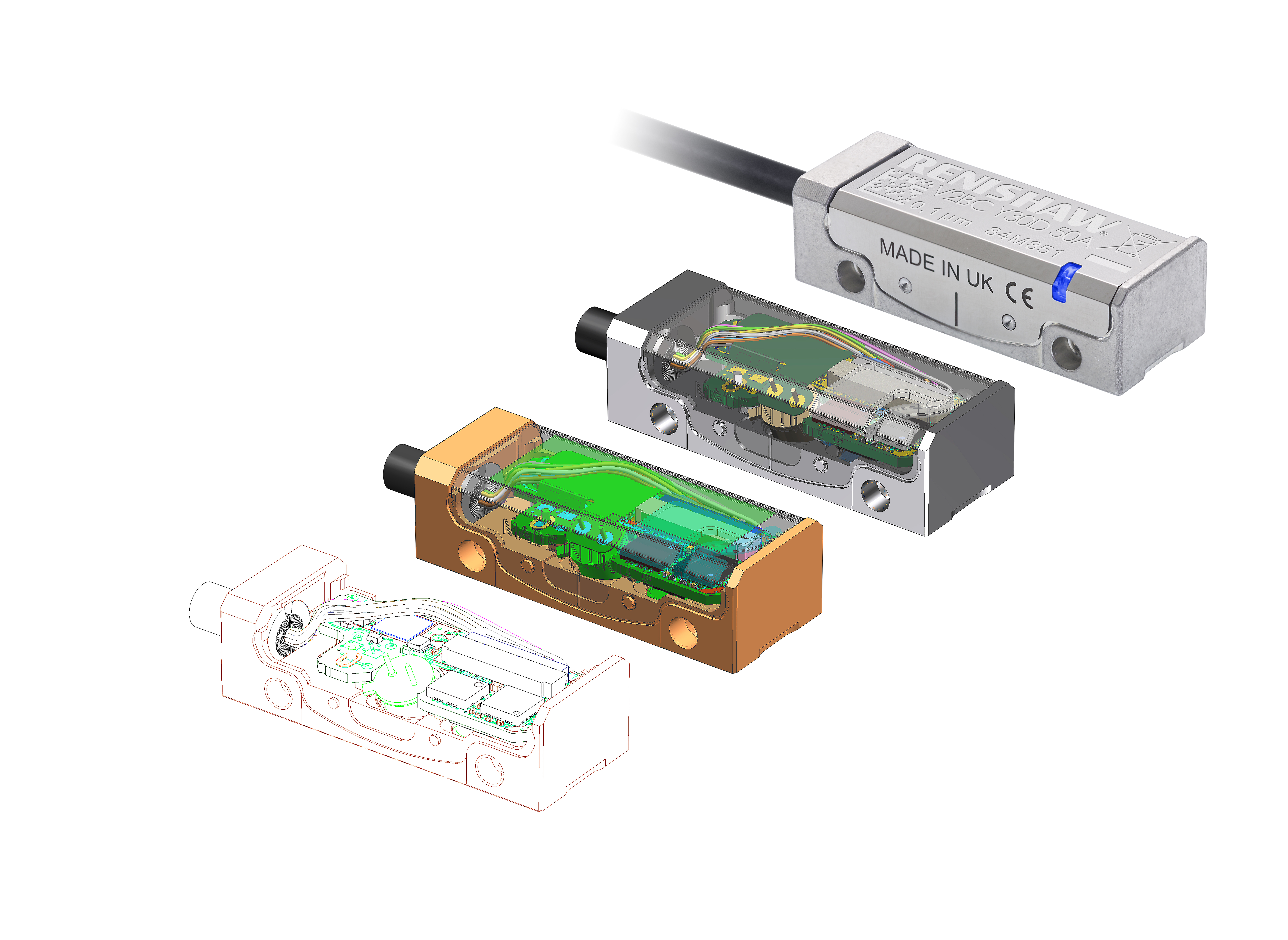

Specified encoders for laser micromachining equipment have high resolutions, low latency, excellent accuracy, small package sizes and low mass. In some applications, digital output encoders may be preferred for communication with digital real-time controllers. The VIONiC encoder series is an all-in-one digital incremental encoder solution for both linear and rotary applications, which combines all necessary interpolation and digital signal processing inside the readhead in a 35 mm x 13.5 mm x 10 mm package, with Sub-Divisional Error (SDE) as low as <±10 nm and resolutions down to 2.5 nm. These readheads offer a wide range of configurations to optimise the speed and performance of motion control systems.
The VIONiC series has been designed to support precision processes such as laser micro-milling and other techniques for creating microscopic features on substrates as diverse as silicon and plastics. The accuracy of some VIONiC variants is equivalent to expensive ultra-fine-pitch (<4 µm) encoder systems with the added benefits of better yaw and ride height tolerance, easier installation, smaller system size, higher speeds, more flexible scale options including longer lengths, better dirt immunity and lower cost.
Available scale types include metal tape, spar, and rotary rings (including ultra-high accuracy REXM). Scale types offered address both thermal compensation and accuracy requirements: linear ZeroMet™ RELM spar scale features ±1 µm/m accuracy at 20 °C and a near zero coefficient of thermal expansion (CTE).
The VIONiC RTLC stainless steel linear scale is also available with a FASTRACK™ carrier mounted option that effectively eliminates the influence of the machine substrate on scale accuracy – allowing simple thermal error compensation. High-speed performance is also important for high-throughput processes and VIONiC encoders are capable of 12 m/s on linear axes and up to 4,400 RPM on rotary axes. Furthermore, an optional Advanced Diagnostic Tool (ADT) provides comprehensive encoder feedback through an intuitive software interface.
