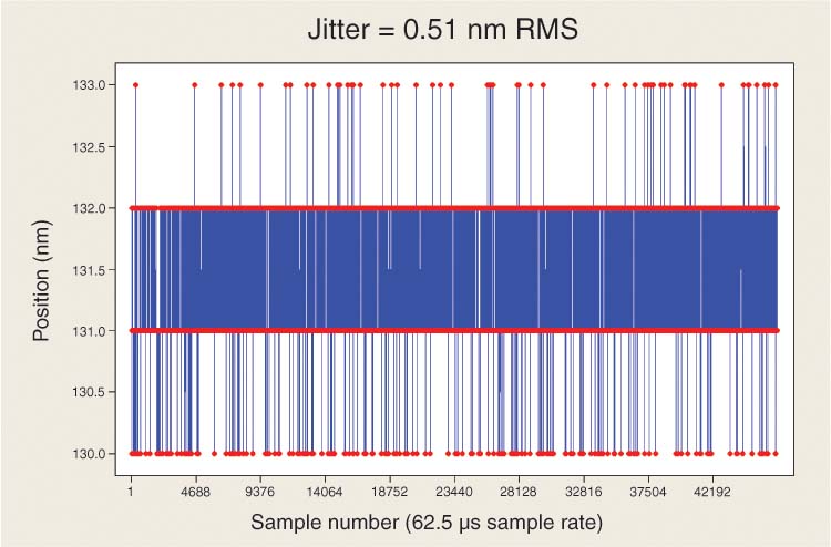

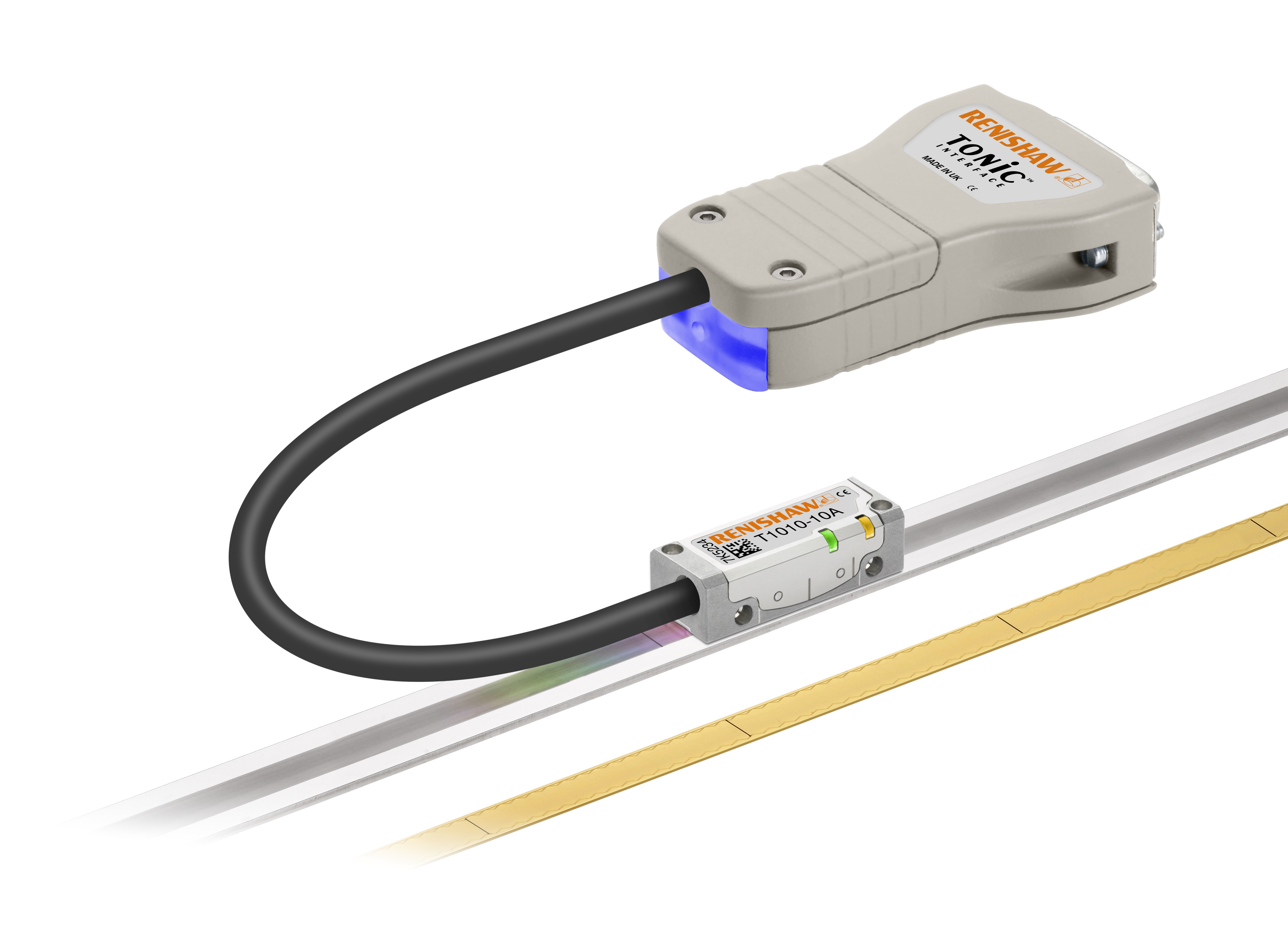

Renishaw, a world leader in measurement and encoder technology, is introducing new 1 nm and 2 nm resolution versions of its successful TONiC™ incremental encoder range. Available in linear encoder and rotary encoder formats, the new higher resolution options comprise a standard TONiC readhead and new Ti20KD (1 nm) or Ti10KD (2 nm) interfaces that apply high interpolation rates to achieve very fine resolution. Furthermore, TONiC’s low-noise optical scheme with superior photometry has been combined with advanced filtering inside the Ti20KD / Ti10KD interfaces to reduce the jitter (noise on reported position) to an impressively low level of just 0.51 nm RMS.
Significantly enhanced positional stability
The reduced jitter and increased resolution result in an encoder that provides significantly enhanced positional stability and low-speed velocity control. This improvement is additional to the benefits of the dynamic signal conditioning included as standard on all TONiC readheads.

The linear encoder version of TONiC is available with a comprehensive range of scale options. RGSZ is the latest evolution of Renishaw's ubiquitous gold tape scale, now with integral IN-TRAC™ optical reference marks. RELM ZeroMet™ spars offer “zero” thermal expansion and ±1 µm accuracy on lengths up to 1130 mm, whilst for high performance on long axes and significantly more robustness than glass scales, RSLM stainless steel spars have a total accuracy of ±4 µm over 5 m, with lengths up to 10 m available. Additionally, for very fast and easy installation, the new FASTRACK™ linear encoder scale system comes with low-profile RTLC tape scale, offering ±5 µm/m accuracy.
Rotary (angle) encoder options are also well served, with RESM rings in a range of standard diameters from 52 mm to 550 mm, with even larger sizes available. For even higher performance, ultra-high accuracy REXM ring encoders have a total installed accuracy better than ±1 arc second on ring diameters greater than 100 mm, when used with dual readheads.
The interfaces have been named after their interpolation factors: Ti20KD refers to 20k digital interpolation (post-quadrature), which equates to 1 nm resolution.
