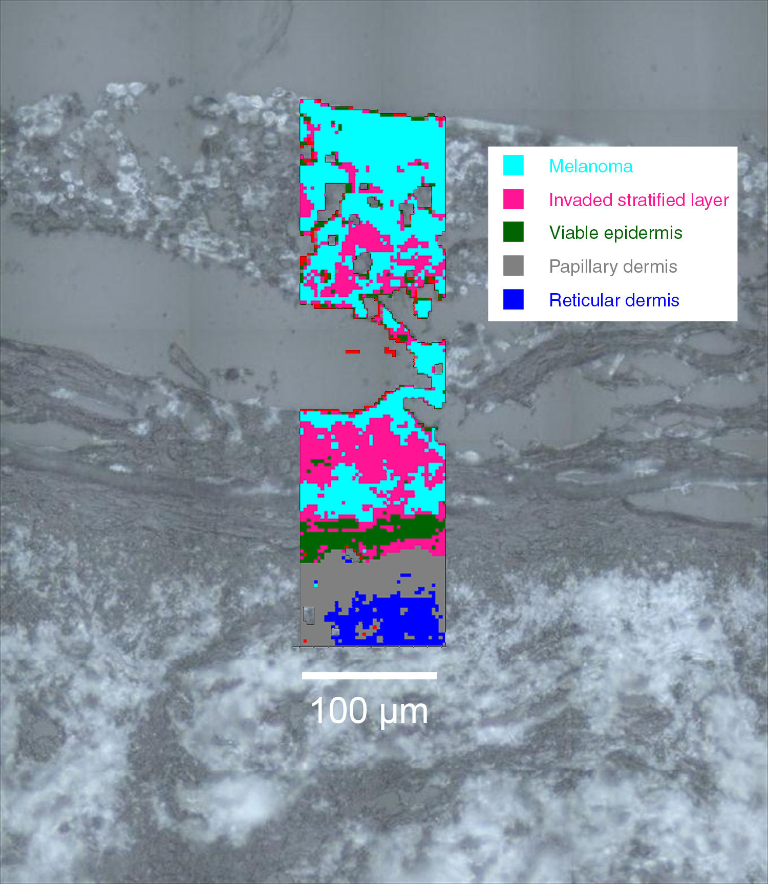

Quickly and accurately identify tissue layers
Distinguish, identify and demarcate pre-cancerous, cancerous and healthy tissues.
- No need for conjugation with antibodies: save both money and time when optimising protocols
- Reliably demarcate and objectively identify anatomical layers in the tissues, based on their total molecular composition. Delineate tumour margins
- Avoid subjective colourimetry and morphology-based analysis
- Identify chemical changes in the tissues that have not manifested themselves in morphological changes (e.g. levels of DNA/RNA, glycogen, lipid, protein, lipid phase and DNA integrity)

Image tissues
Renishaw's StreamLine™ technology is particularly suited to generating tissue images. Its line-focus geometry enables you to use high laser powers whilst avoiding photothermal damage to the tissue. This maximises signal levels and gives you images in the shortest possible time.
Study uneven surfaces
With StreamLine's Surface capability, you can generate images of samples, even if they are not flat.
