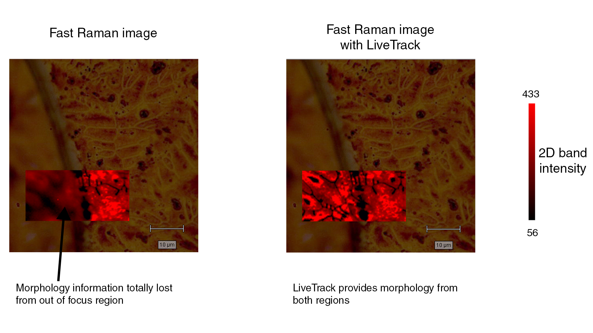

Analyse CVD graphene grown on copper foils
Renishaw's LiveTrackfocus-tracking technology maintains sample focus, even when mapping large areas that are not flat.
