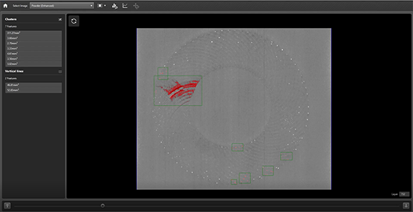

InfiniAM Camera provides visual process monitoring for additive manufacturing using RenAM 500 series machines. A high-resolution camera captures images of the powder bed after dosing and melting for each layer. The software analyses these images to offer insights into build progression and highlight potential anomalies that may need your attention.
The software can send near real-time alerts when anomalies are detected, enabling quick analysis and response.
Enhance your understanding of the 3D printing process and identify areas for investigation with this powerful tool.
Identified anomaly captured by InfiniAM camera
